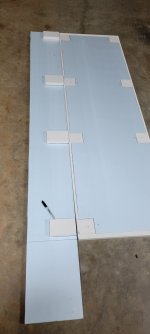

I can offer you a custom frp composite shell but I an the east coast. Might be able to create a kit. I have patented frp composite poptop but that will come later. I have a few projects in the works for a client

Very interested if you can do a box with a pop top. If I end up making my own, I will try to do a pop top so I can keep the box height lower.
Will be late Jan I have to build the 24footer and interior..Pm me. Here is how it works internal struts 2 and 1" composites. Buddy and I built this yrs ago but I have co making me my glues..60 wide max at 75psi roller pressed. I use high density EPS but can get PVC H80 for main body depends on budget. All toppers are xps or eps. Pvc perimter inserts so they can be screwed together as kit
