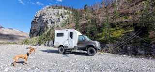

Since there's been a lot of discussion regarding flex, here's a pic of me flexing shortly after I got it back in 2019.
Got out for around 30 nights. Pretty good since it was mid to late summer by the time the camper was ready to go.
Very happy with everything.
Very happy that we went with lots of windows. I see some units that only have a couple small windows: not for me!
Over winter I will pull out the drawers, cabinet doors and table and finish the fronts on all of them.
Initially left unfinished just so we could get out camping instead of building.
The layout works perfectly for us.

We travel with the bed in the lower position and a mesh door drops down to keep the dogs safely in their spot.
Way better than having them loose, especially when off road.
The Espar heater has a fan-only mode so it can draw cooler air from the front of the camper and recirculate it back to the kennel area.
