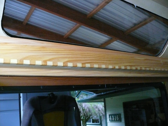

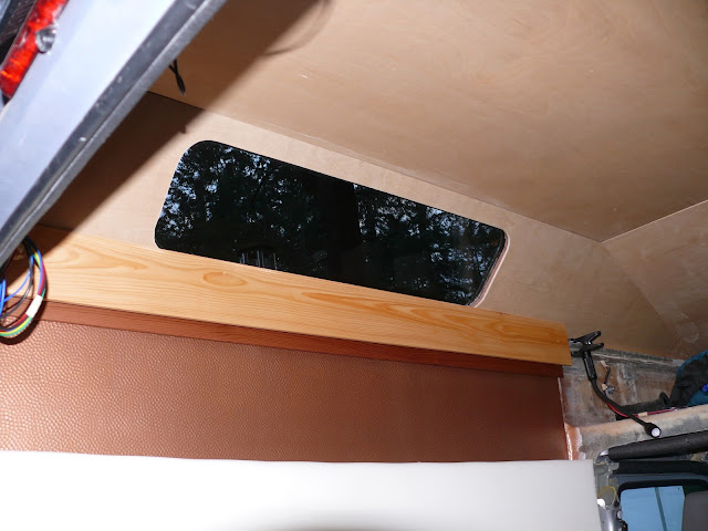

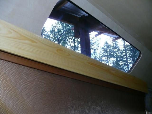

56 - Upper rear cabin walls...
(above) Keeping it simple... Fence board cedar...
(above) The boxjoint tray is leftover from an entry column job a few years ago... A dado was ripped into the fence board and the wood was screwed and glued... Only over the sink side...

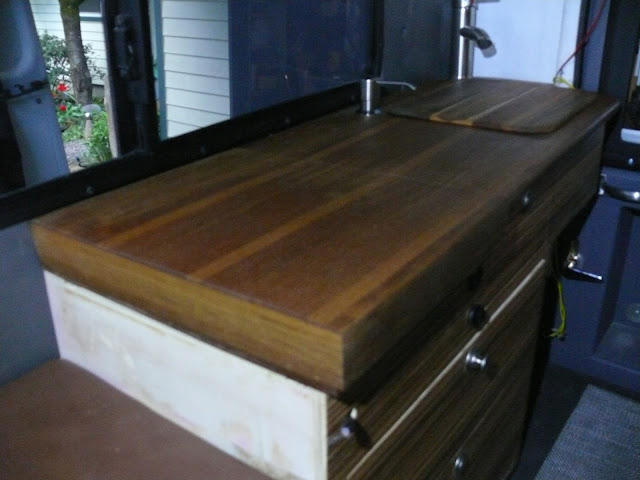

(above) The stove cover/cutting board in done... Magnets hold it in place... Doubles as a lap tray...
(above) Trying to keep it simple up here so the fancier woodworking can be the focal point... Fail...
(above) 1.69 each...
(above) The bed/seat curb is done... Simple box joints keep the corners together...
(above) Keep it simple ...

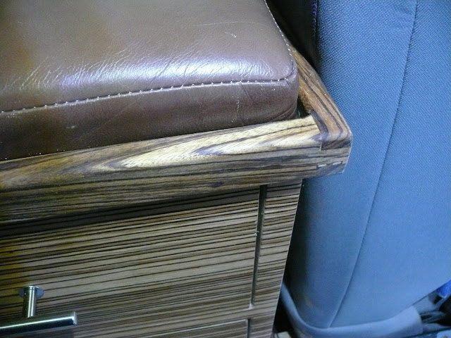

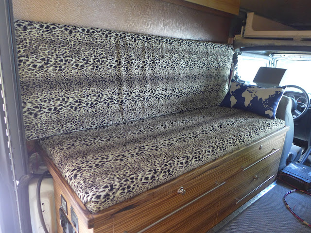

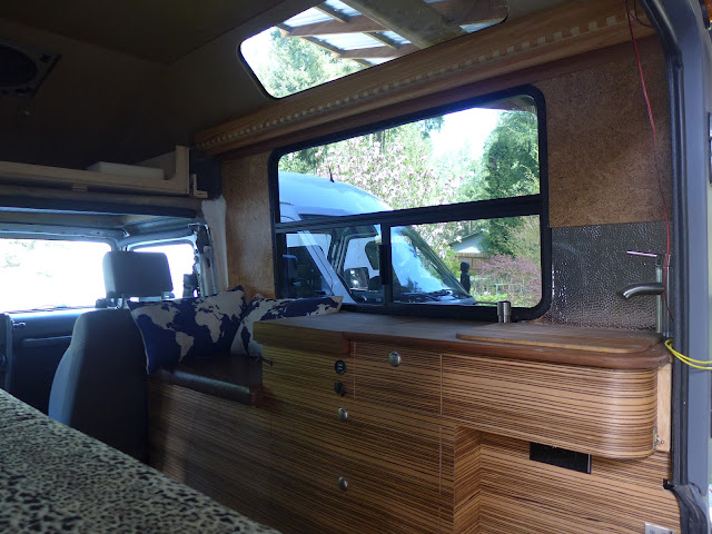

58 - Walls and Upholstery
(above) Found some interesting fabric for the bench seat/ bed and wall cushion (not shown here)... The area right above the bench seat is now finished off with redwood sealed with Watco Danish Oil...
(above) The wall cushion is sized to fit on the floor for another sleeping option...

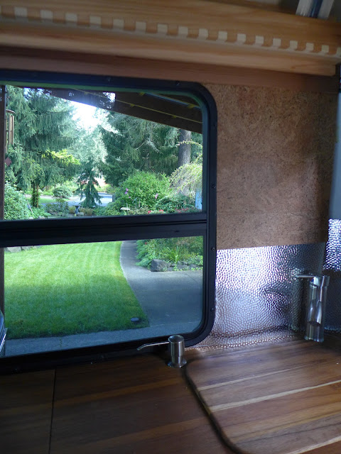

(above) The curb-side walls are now completed...
(above) Cork, and a bit of hammered aluminum over the sink...
(above) Glad to get all of this done...
