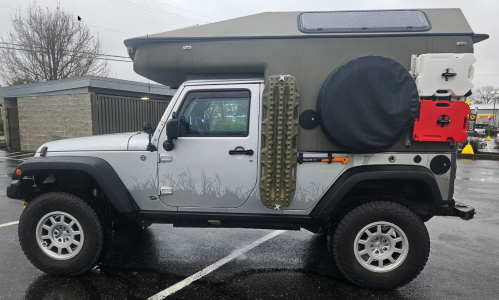

Some interesting news is that, preparatory to a planned serious daytime off-road use in Moab (with a nighttime condo and many others along to carry recovery gear), we've temporily created the XV-JP LITE version. I've emptied my drawers out, reduced the on-board water down to just the main Rotopak, taken out the microwave (kept the small fridge) and so on. After I did that, I took it to the scales and, after taring out my weight and the petrol, figured out that it now only weighs about 5,700 pounds. I'm sure 5,700 pounds (correctly) strikes people as a lot, but this vehicle was just over 7,000 pounds when it left Earthroamer. And since the biggest and best change is your lightweight fixed roof, you should take a bow. (y)
Typing this from Moab as we pack for the return trip back to Portland.
Will have a trip report put together in the next week or so but here is a teaser…
The XV-JP can now proudly wear these three stickers😎
Will leave it up to Mike if he wants them on or not…
Many thanks to Chris and his copilot/son Liam for taking the XV-JP to what might be considered it's natural habitat. #003 used to get out occasionally doing competent off-roading, and Paul took a couple of adventurey trips, but it's not done anything noteworthy since I got it back. And as my own off-roading days are behind me, I was really glad that it could get used on a proper set of trails by an experienced driver.
Chris has been giving me some reports and photos over the past week and it seems to have done well enough. It did all that was asked of it and didn't break. We'll debrief when he gets home and see what we learned about the current setup. This is the first serious trip with the (comparatively) skinny version and we may need some suspension changes to optimize for the new feathery weight. Regardless, though, I'm really happy and look forward to this sort of thing happening again sometime.
