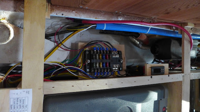

59 - Rear Lights and Interior Electrical

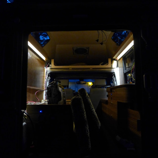

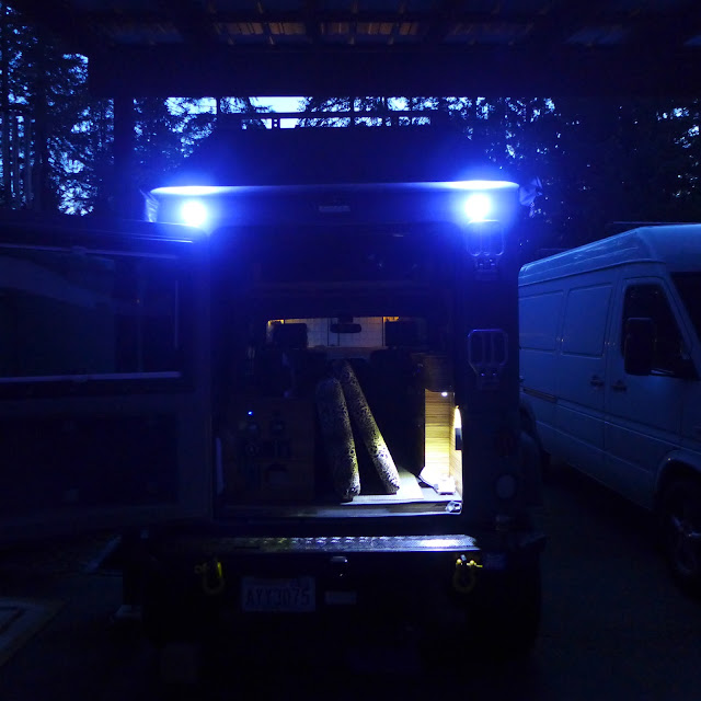

(above) The lights under the rear porch are now all white/clear... There is attached to the porch lights another led lamp that illuminates the rear step... Call them porch lights... Also changed are pair of back-up lights... Like the screw-in mount much better than that plastic-wax-ring-push-on type of lights...

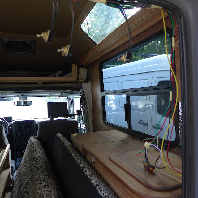

(above) R to L: Center Spot - Side Lights - Cabin Lights ... On the wall: Water pump and Hot Water, on a timer... Both will have marker lights to keep you focused...

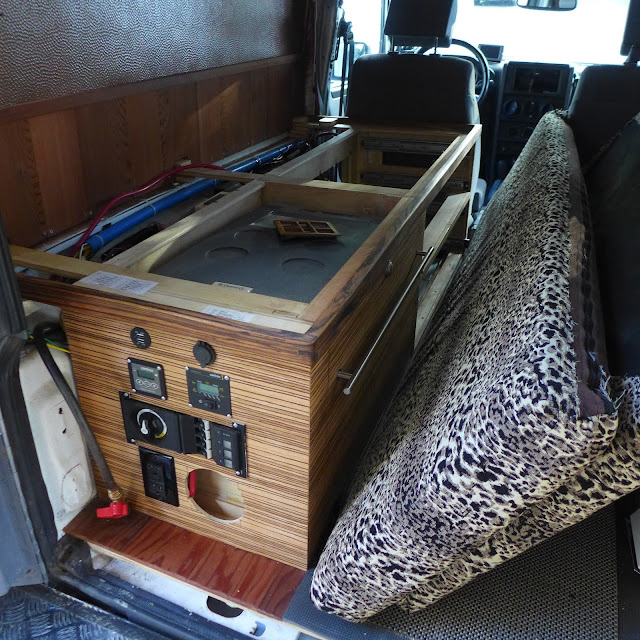

(above) Stoked to get the batteries in...!!!...

(above) Porch Lighting... A pair of cheap 2.5" LEDs and a single tiny LED at the rear step... Switched on the sink base cabinet face...
(above) Interior wall recess lighting... LED strip lights behind wall trim board... On a dimmer... Looks cool in any other picture than this...

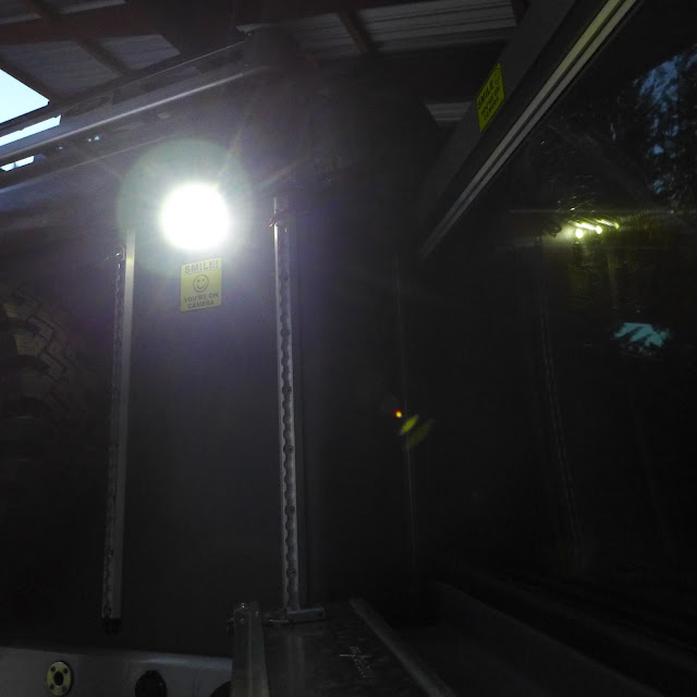

(above) Awning Lights... Single tiny LED lights... Two one each side... Look like security cameras when not illuminated...
(above) Driver side Awning Lights... The sticker near the light says "SMILE YOU'RE ON CAMERA"... Level One, of the new security system...

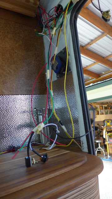

Finalizing the fitting and connecting... All rear cabin 12 volt is connected and working fine, one battery is connected to power the systems... Slow going but fun...

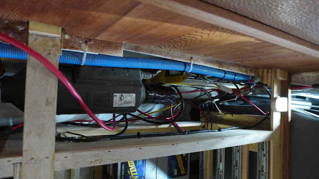

Fit the water intake/cleaning access port to the water tank... Flushed out the tank, then refilled it with bleach water... Let it sit all afternoon then turned on the faucet... Water was spraying everywhere from the seam at the water pump... Bleach water... Filled under the front carpet... Damn...
Drained the tank, sponged it out and pulled the carpet... Looking for a positive after that, at least it's sanitary under there now...
I had drained the water tank in the fall, but there must have still been some water in there during one of our many deep freezes this past winter...
The new pump will be here Monday... Changeover should be simple...

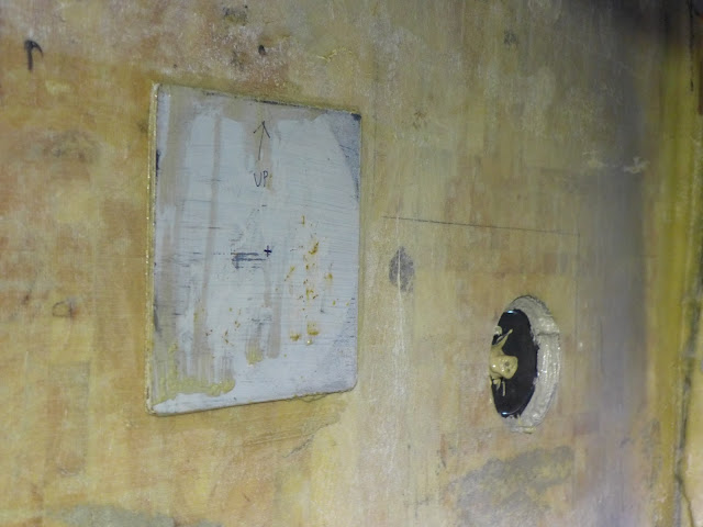

How is the spare tire braced/supported by the hard top?
Mounting it to the passenger side would be my goal. I have the Rhino-Rack Back Bone on my hard top so it could tie into that as well. While Ild rather have the tire inside, outside would work if I can get it braced/supported properly.
[/QUOUTE]
The mounting plate for the tire support was originally fabricated for the Jeep when Mike had it... The mounting plate is roughly 10" x 10" , made from 1/4" steel with three 5/8" bolts welded to the plate... The side walls of the rear cabin are about 3/4" thick and rigid... No worries about strength... The mounting plate was bedded to the interior wall with polyurethane construction adhesive... It ain't going anywhere...
