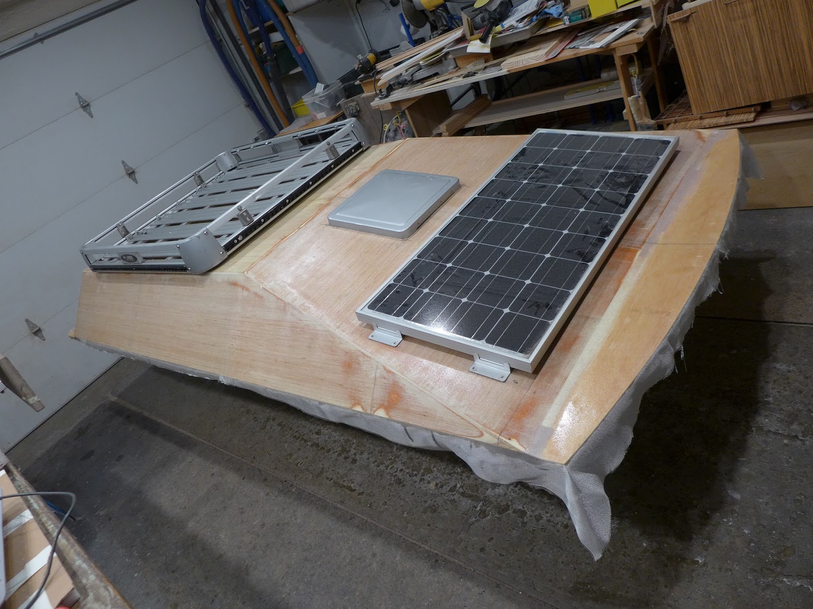

08 - Roof Components...

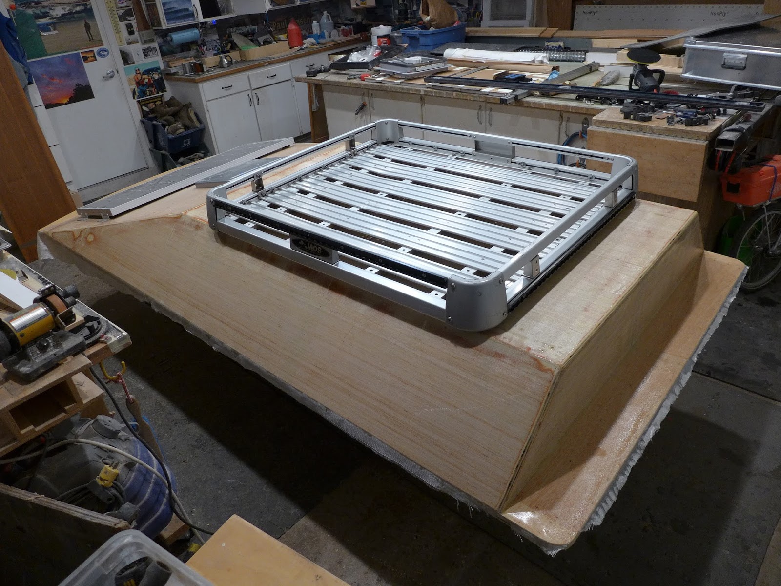

(above) Solar up front to take advantage of the sun angle, the fan forward so my head does not hit the switches, and the roof rack overhanging the center section of the roof just slightly... Using what I have...
(above) Didn't think I wanted to use this, but it a great rack and more important, the load points are perfectly placed... Next, maybe this weekend, internal reinforcements for the roof rack and fan...
