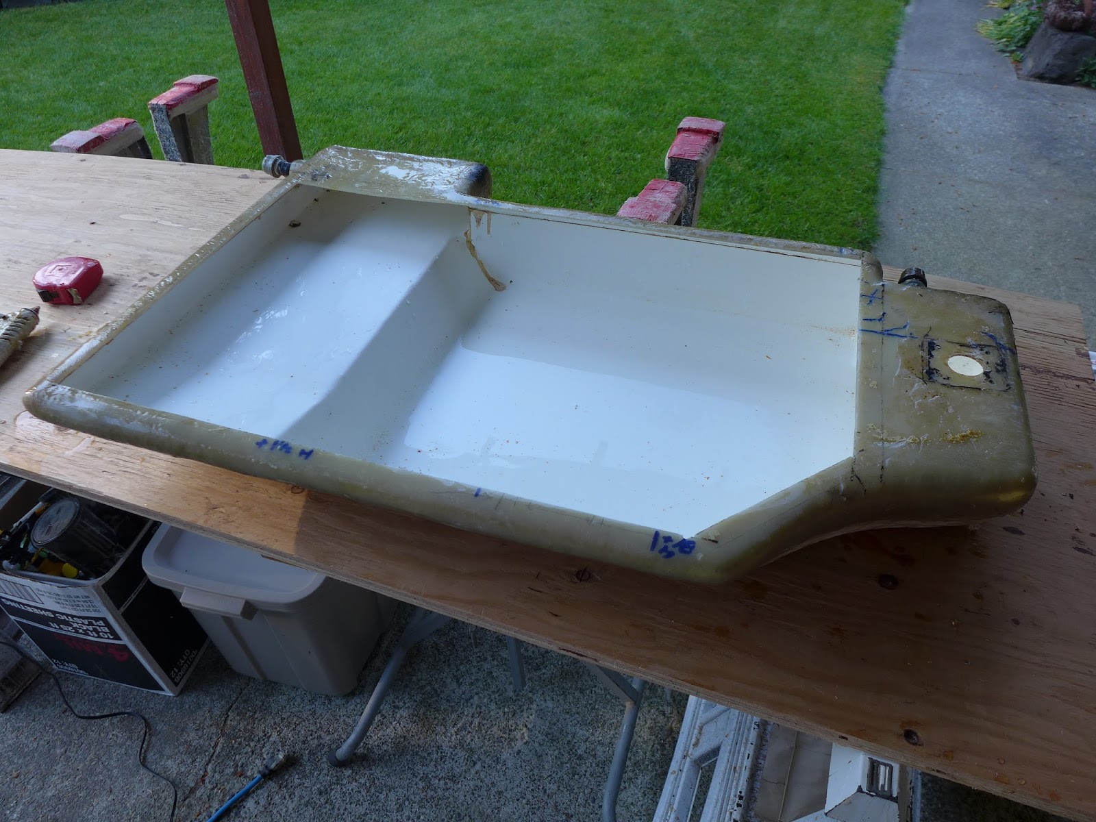

(above) The former grey water tank sits below the floor level and currently has an exact capacity of ten gallons...

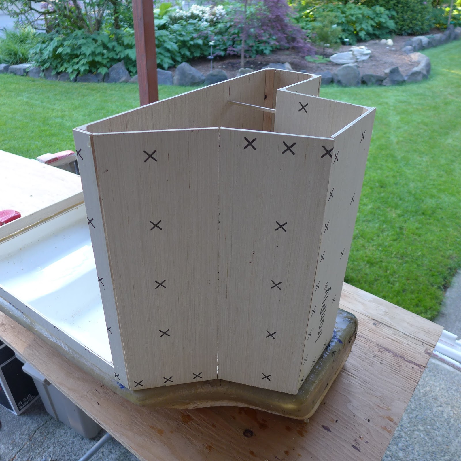

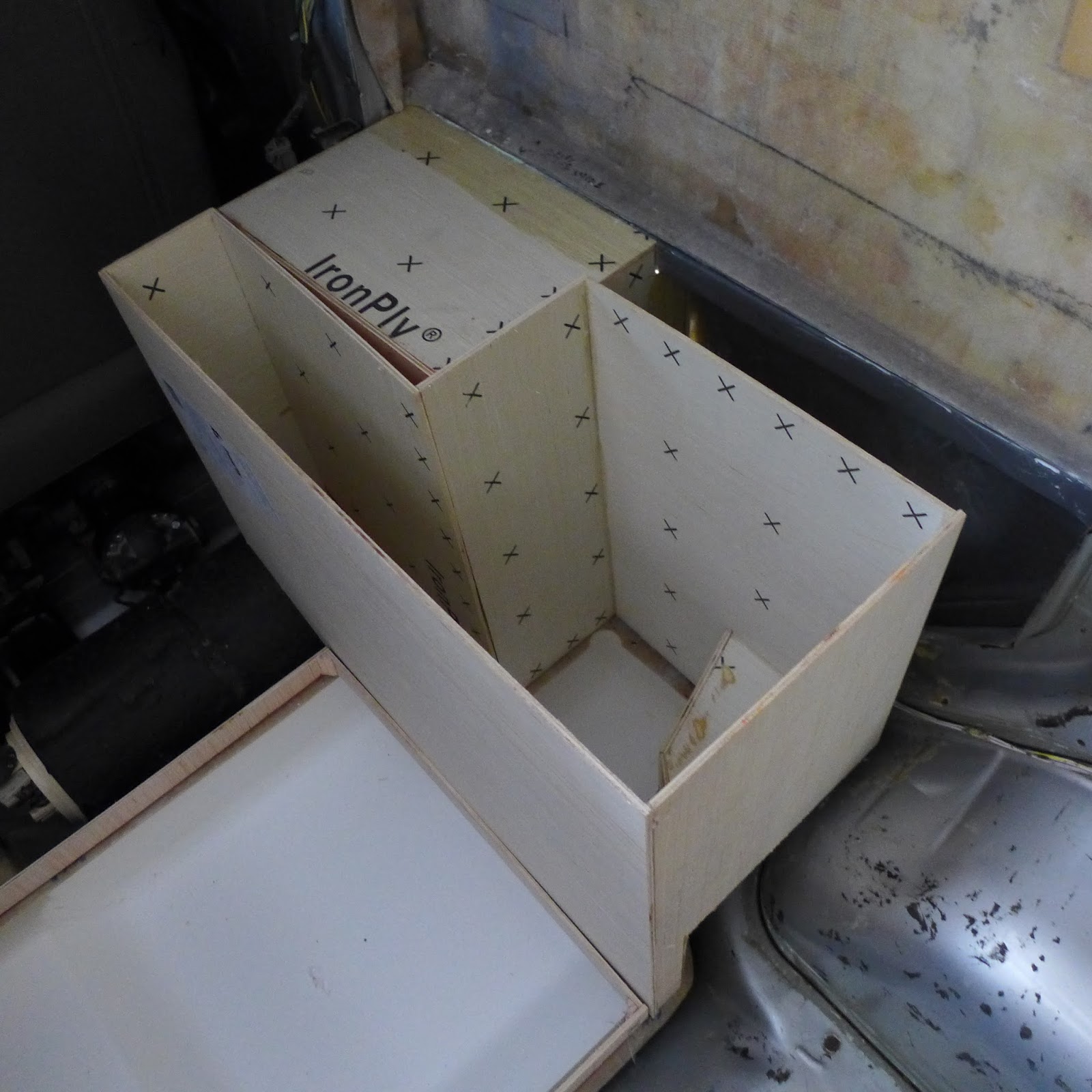

(above) To increase the capacity, the tank will fit within the future curb-side cabinet... At the tallest, the tank is being extended 18"... The notch arounds are for the water heater...

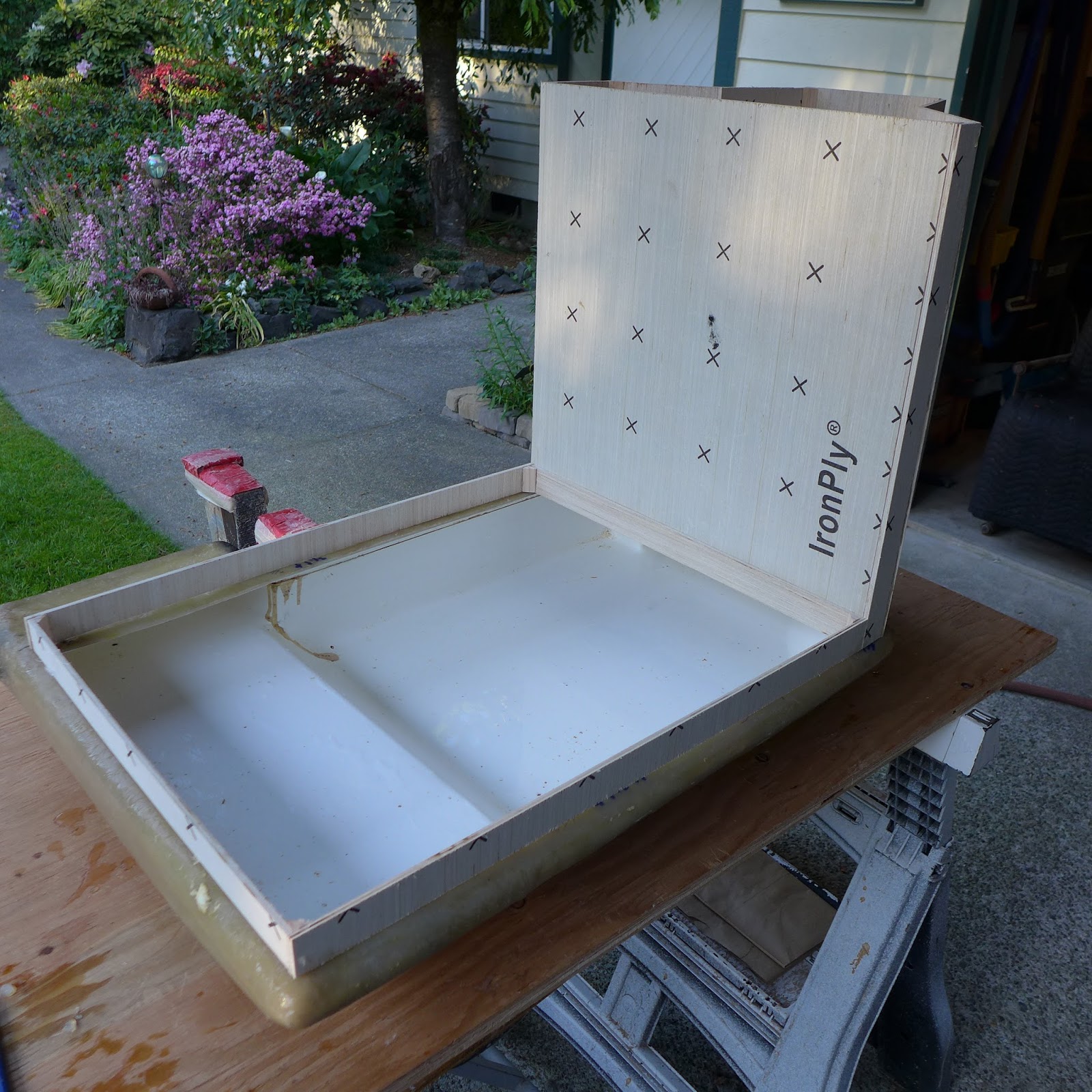

(above) The 1/4" plywood parts are hot glued together, and will be substantially fiberglassed seamlessly with epoxy resin... Fast and easy...
(above) Over the under floor portion of the tank, it is being made 1.5" taller... Might as well make it as big as possible, without becoming obsessive about it...
I did a quick volume calculation and the new tank will have a 22.5 gallon capacity... Wow...!!!...

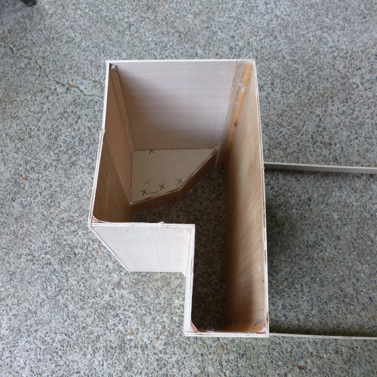

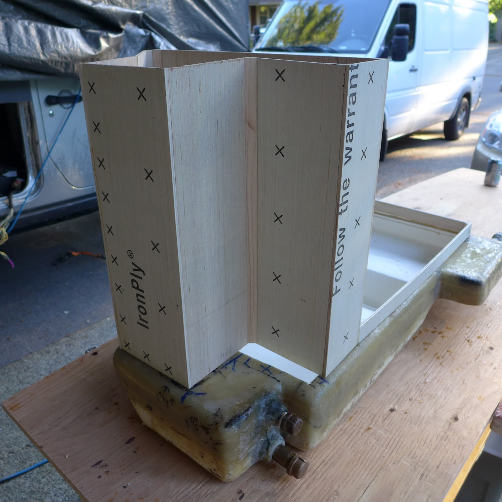

(above) The tank that was started last week can be made bigger... Extend the front and rear sides to gain hopefully another gallon or two...
(above) The first tank has been modified on the rear edge, but not the front... I decided to get a fresh start on the new tank with fresh plywood and no spliced seams...
(above) A half hour later and the new tank base is hot-glued together...
(above) The new combined old and new tank capacity is 24.72 gallons... Close to what I was hoping for... I will get it fiberglassed this week... Stay tuned...
