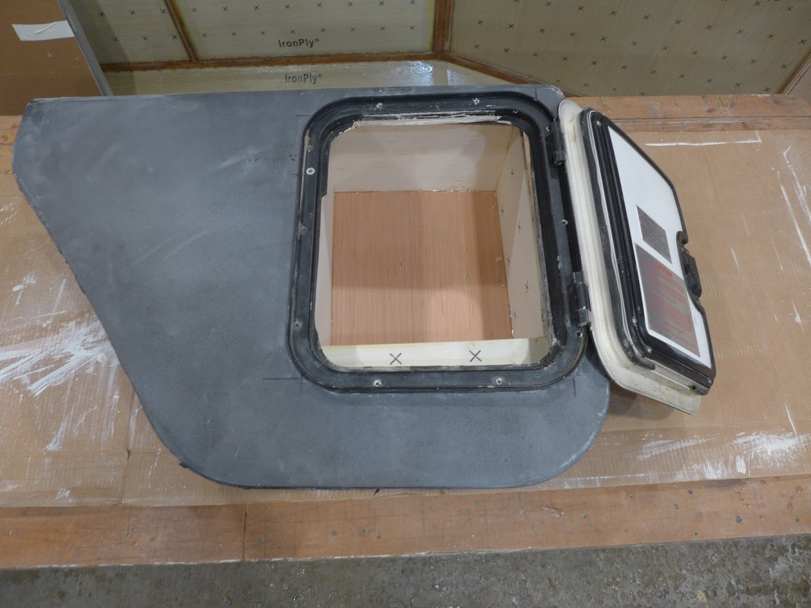

09 - Propane Locker...
(above) The curb-side rear door lower panel was cut to have the access door for the propane locker... Originally it was the access hatch for the canister toilet...

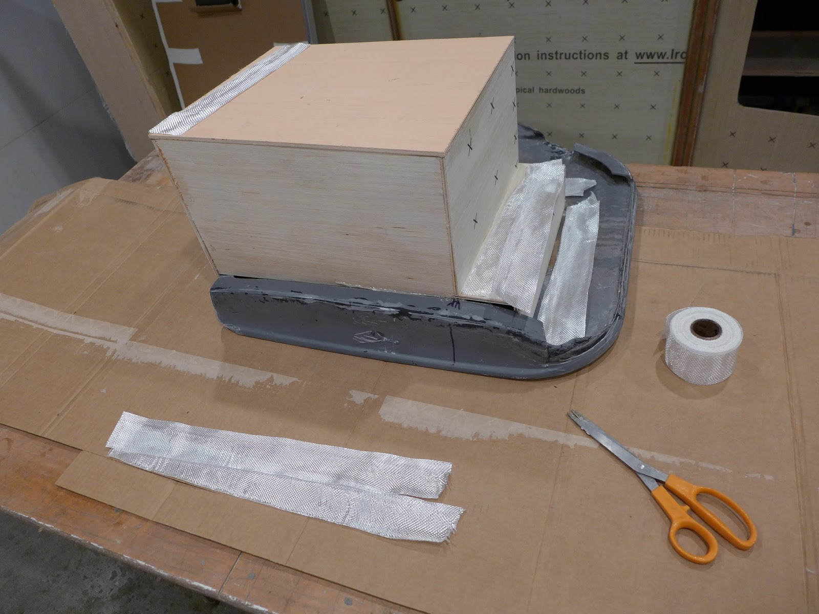

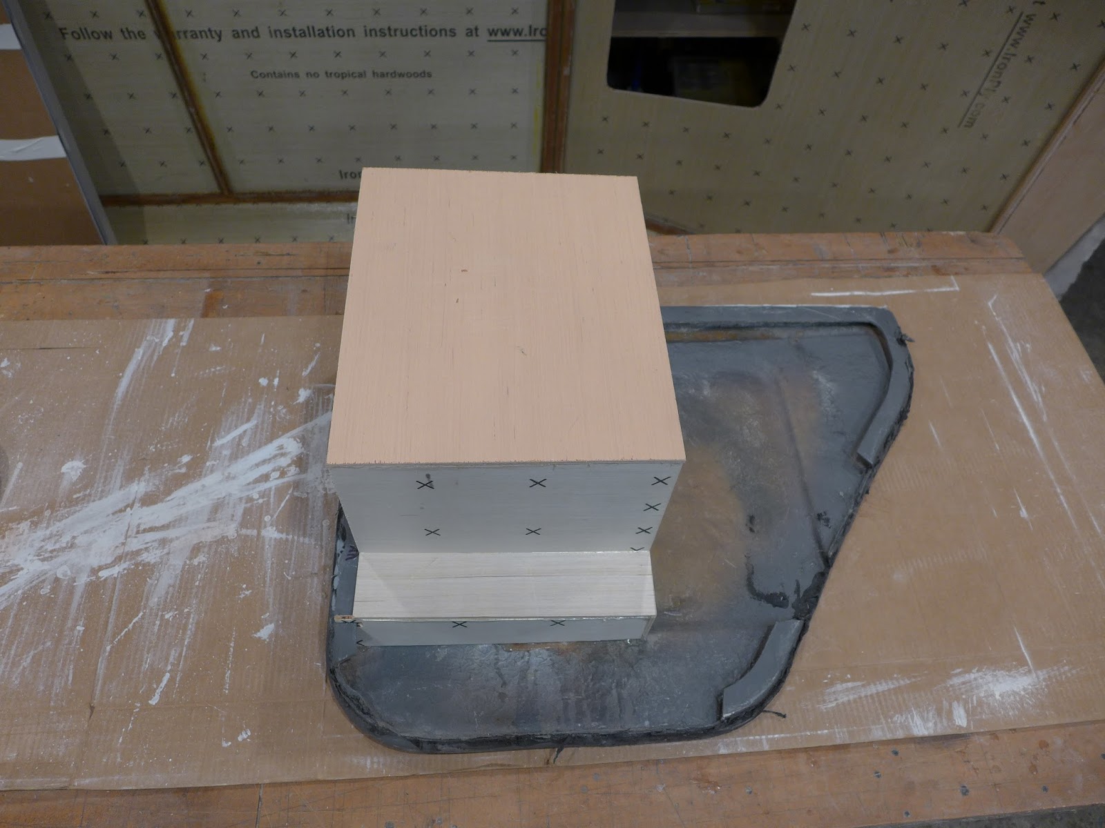

(above) Using 1/4" plywood and a hot glue gun, the compartment was tacked together and to the panel...
(above) The notch on the cabinet is due to the water heater placement... As always, things are tight...

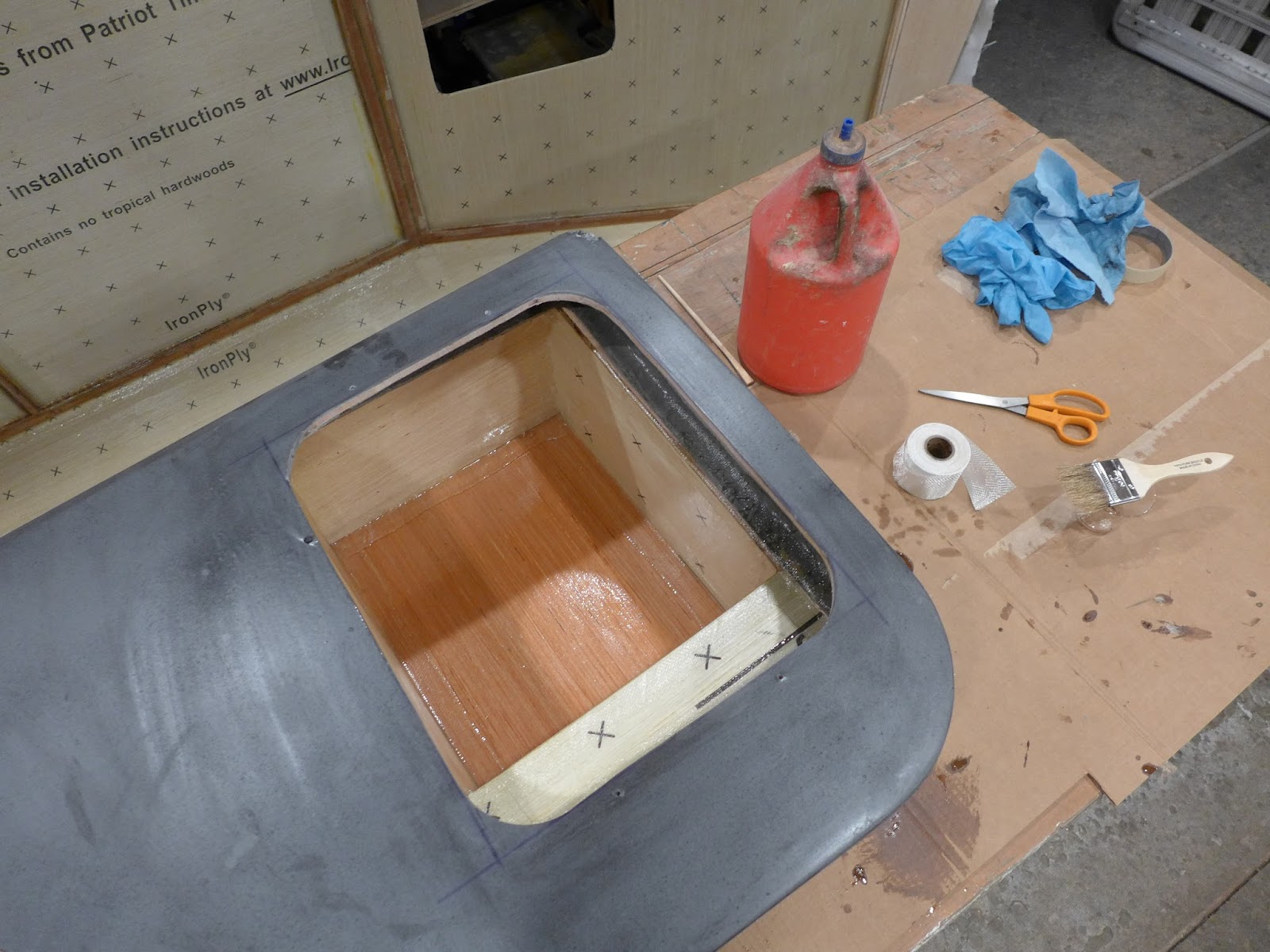

(above) Fiberglass tape on all the corners...
(above) On the inside too... It needs to be vapor-proof to the cabin...

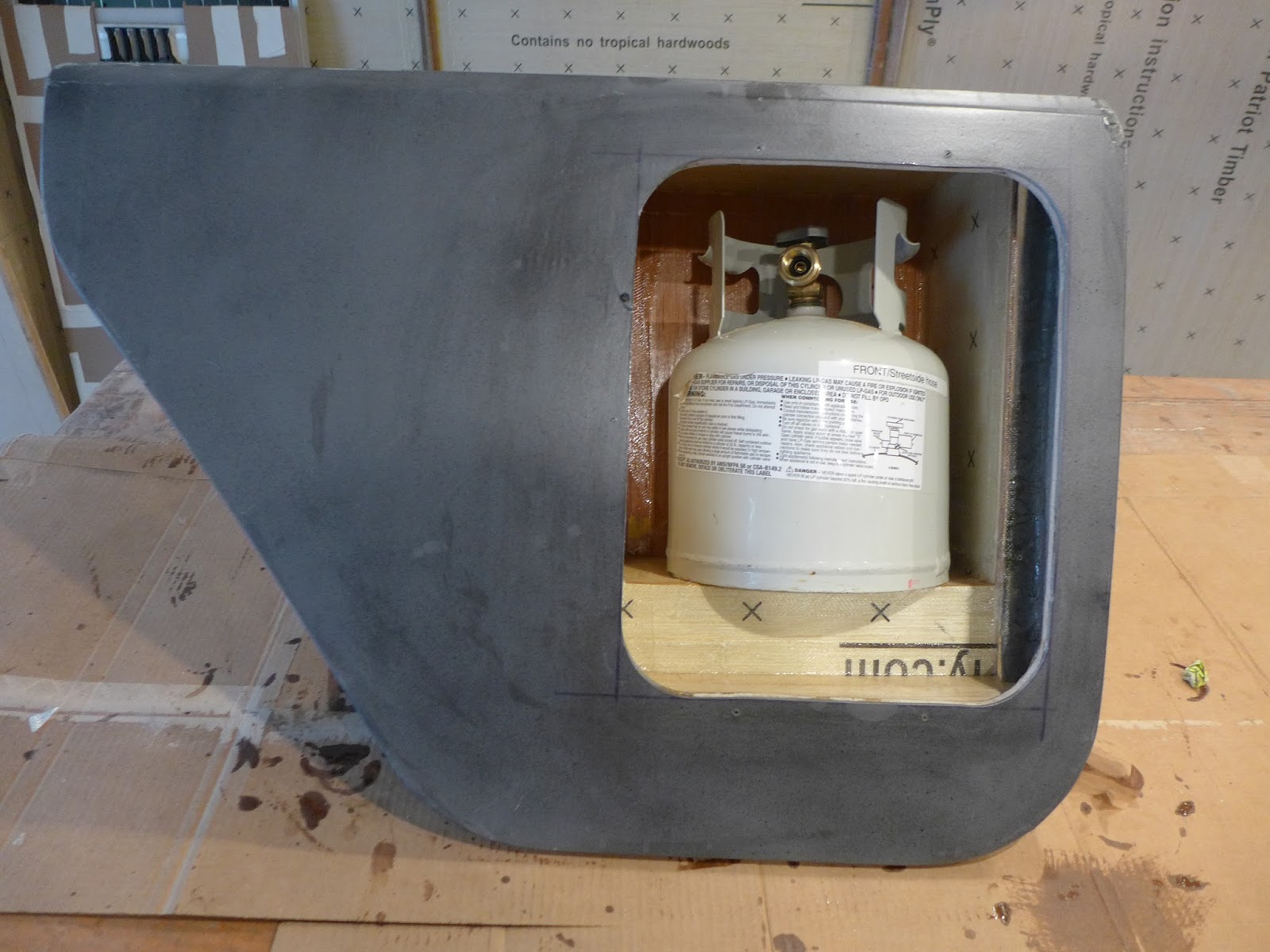

(above) The tank fits fine and there is room to mount a pressure regulator on the wall...

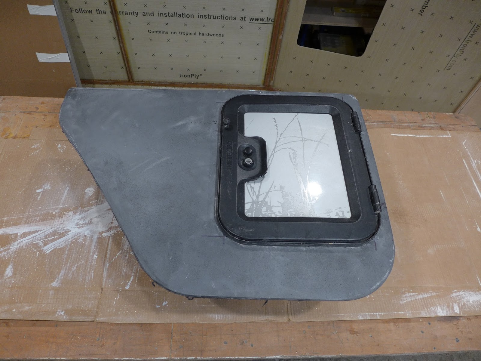

With the propane locker essentially ready to install, measurements for the new custom fresh water tank can be made and the tank built...
