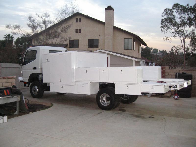

I'm surprized that your genset is not on rubber damper feet.
Those dome shaped things between the genset and the slide are rubber mounts. It's hard to discern that since they are all painted red.
Joaquin Suave said:
So what do you guess you GVW to be?
The spring packs are designed for 10,000 lbs / 4,536 kilos rear and 6,000 lbs / 2,722 kilos front.
I think we'll be right up on that.
We're taking the rig to a scale when we get it done and fully loaded so we can weigh each axle, each side and the front axle weight when elevated. The goal is to calculate the roll center so we'll know what the baseline static roll angle limits are. Keep in mind however that whatever the math says our limit is, our actual limit is determined by my wife's Pucker Factor Meter (PFM). :littlefriend:

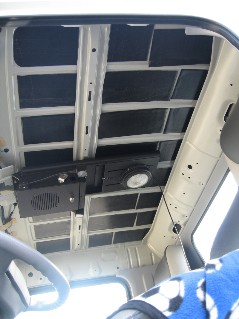

cab without headliner, sound isolation mat installed, overhead console mount & position test

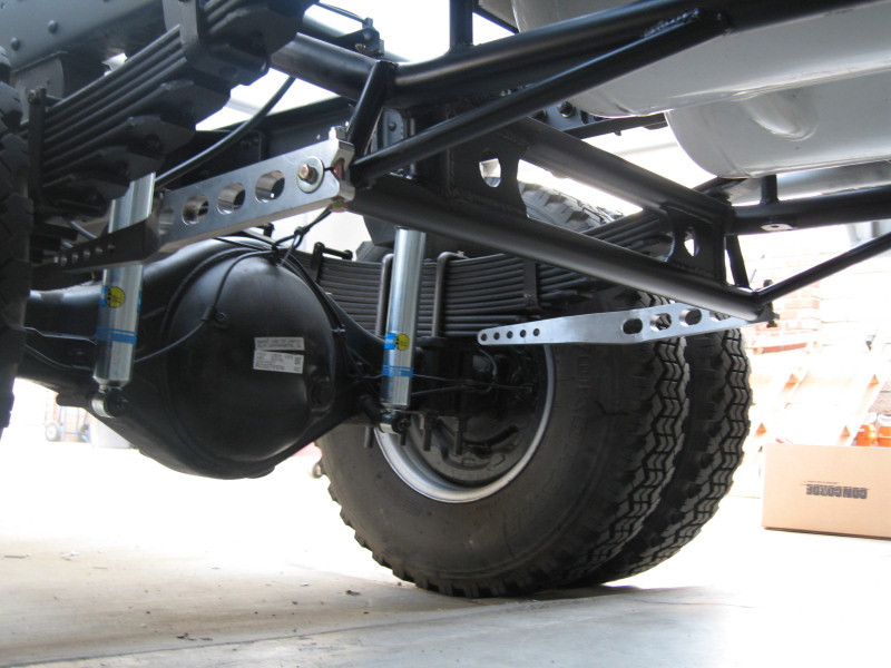

sway bar mounted, awaiting heim joint linkage
