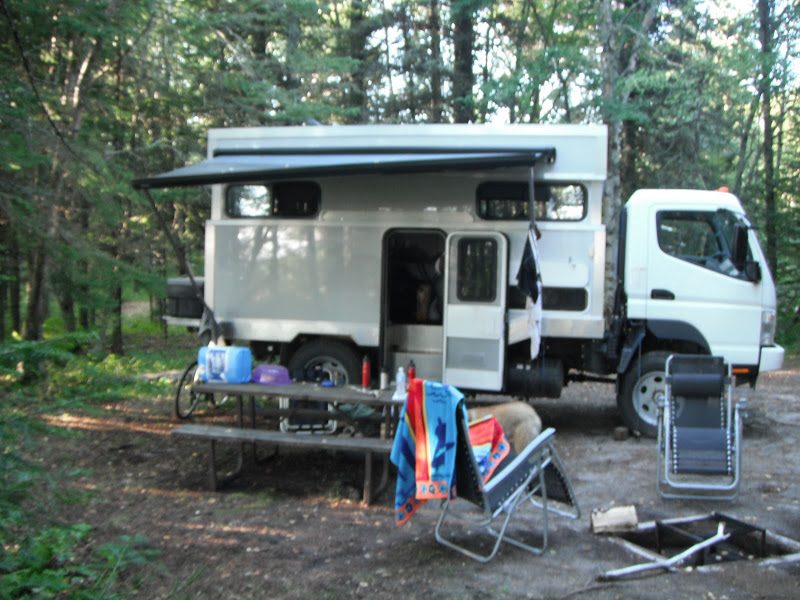

here's a pic in Neys Provincial Park, cant seem to get the size right , sorry
dzzz
I believe I have brought this up before, but is your individual tire capacity rating much higher than needed on the front? Do you know your axle weights? On a cab over usually the front suspension is going to be within a reasonable range (meaning there's enough weight to move it and it's not bottoming).

DZZZ, the tires are much more than needed capacity wize, front axle weight is 5500 lb and tire max is 5200 each, I am running with 40 lb air, I know the tires should give more but was really hoping the suspension would do more

Wow, some trucks and some pics.
First, I don't have an FG so I'm only speaking generally.
2X capacity on commercial road tires on a heavy duty pickup would produce a harsh ride. Your sitting on top of the tires in a cabover that doesn't have room for a great suspension design or much movement.
I'm sure people here can tell you the best FG rough road tires and maybe you can compare those products to what you have.
I've paid more for lower rated tires of the same product to avoid stiff sidewalls. And that was on a pickup that rides much better than an FG.
