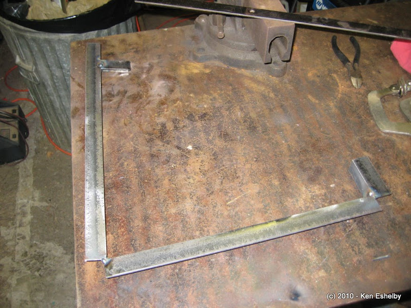

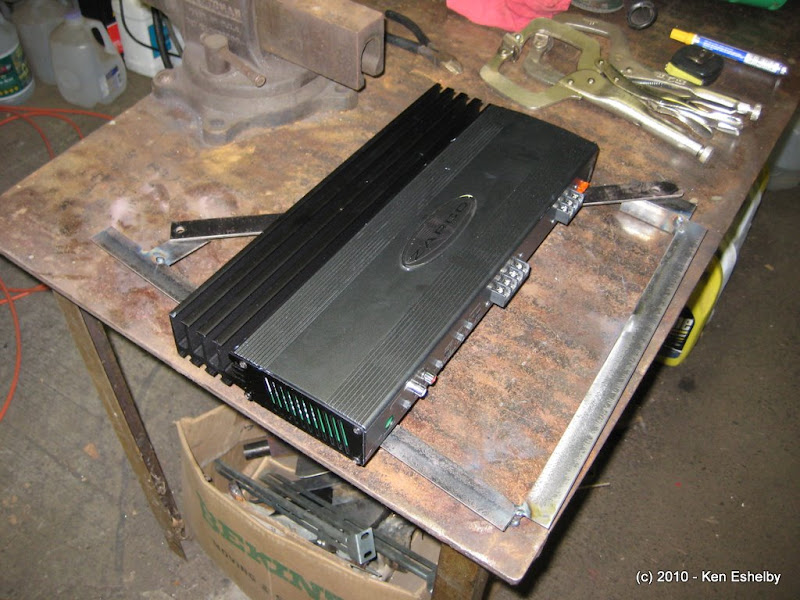

Onto the 2-channel amp...

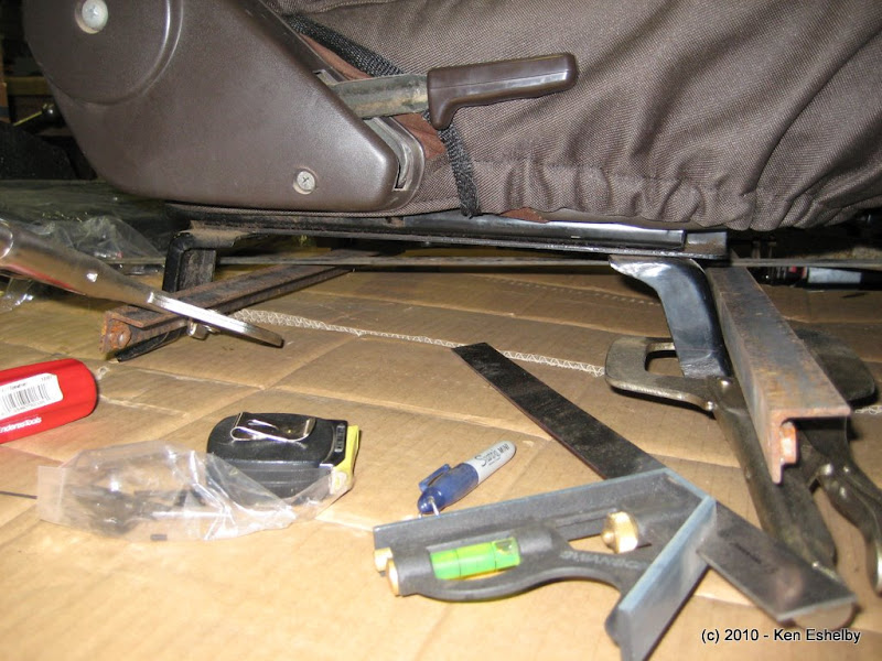

checking the lay of the land.. there is nothing square about FJ62 seat brackets..

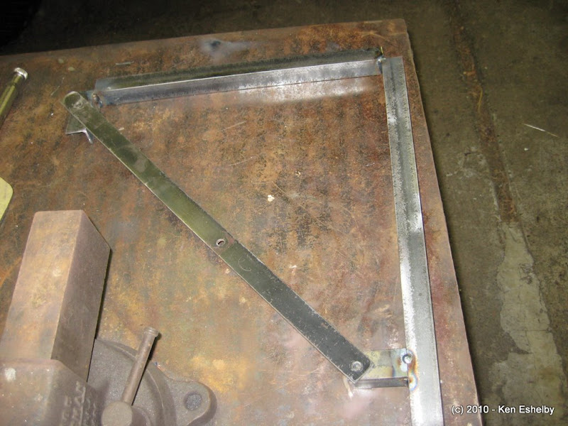

this is what I came up with from scrap on hand

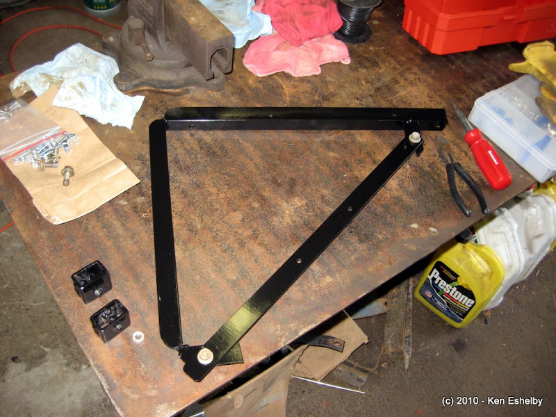

finished and painted.. rounded off some of the more accessible corners and left the hidden ones for a surprise for my hands one day

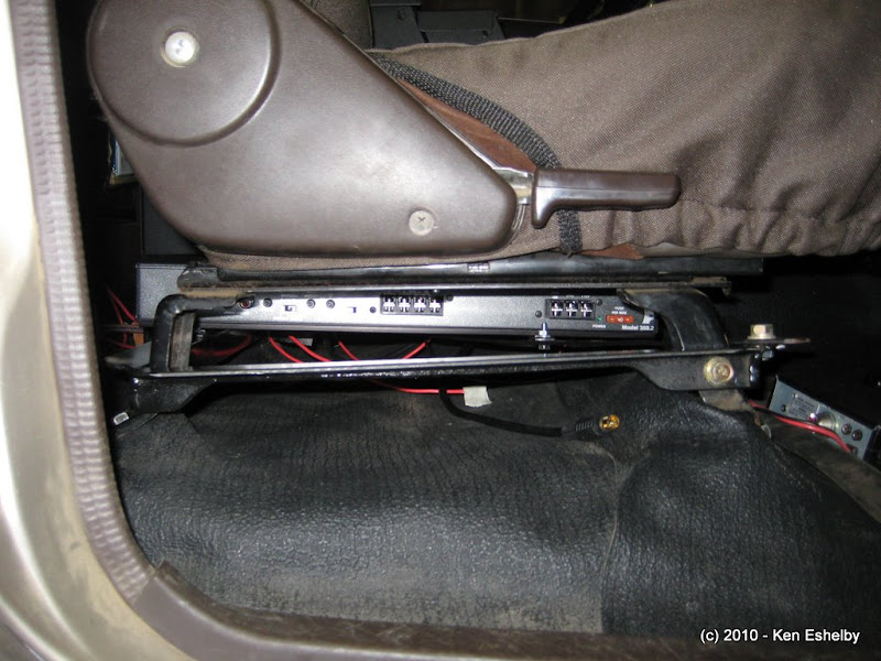

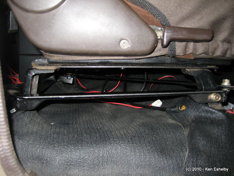

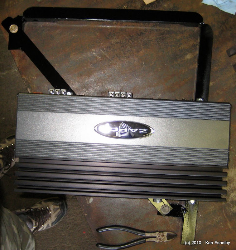

final amp location, again with the harping on about how cool the Zapco install feet system is
possibly a design flaw.. have to install the bracket and then the amp. I clearanced the outside bracket to be able to shove yet more crap under the seat
payoff.. amp sits nice and high, tucked under the seat. out of the way and can still get to the adjustment doodads easily. it would be hard to steal without a few minutes of frustration ;)

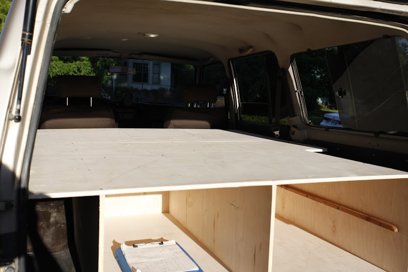

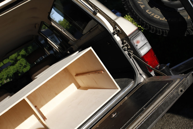

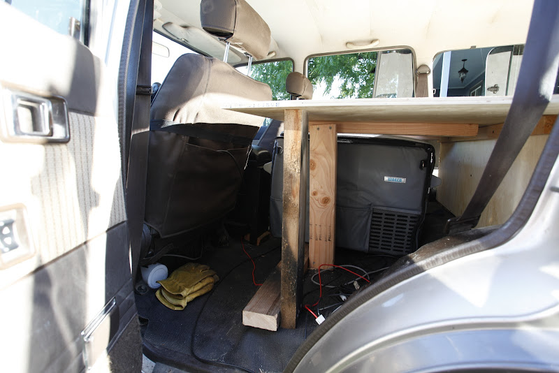

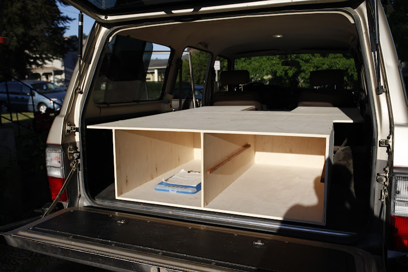

Got a start on platform v2. It is pretty tall, but that is the requirement to clear the fridge. I will try it out and see how it goes. I need to build boxes into the front sides for clothing and do some drawers for the rear. I used Baltic Birch 1/2". Kind of a compromise of lightweight/strong/fairly easy to work with.
the open area is the cutout for the fridge access panel. it will be hinged toward the rear and is supported by 2x4s which tie into the front supports
front area.. i kind of cheesed it. I like the open space but the supports tend to interfere with just about everything. I am rushed as i'm leaving for the FJ Summit in Ouray (crashing with the HZ-powered 62 :cool: ) so whatever gets done will have to do for my 3-week Colorado trip
rear area. left side will be a large drawer for parts, right will be 2 drawers for camping/food I think I should have offset the center to have larger camping side drawers but that is easy to redo when i get time.. just have to build new drawers as well
you can see a little of where the water can goes. just a cheapo plastic that doesn't have plastic flavor or leak. i use a super syphon to pull water. this was one of the reasons to have Kevin redesign his fender panels to lift out. hinged would have been a huge PITA. With a lift out panel, i only need about an inch of space to get into the fenders.
entire surface. i will have to add hinged flaps in the front for a little bit longer sleeping surface. platform v1 was 74" long, platform v2 is 66" for now I'll just stuff junk behind the front seats to make more surface.
I am sleeping on a 2" double/full size memory foam mattress.. sort of medium hardness. It will be sweet to sleep with real bed sheets and covers. Mattresses are about $120 on ebay. Next one will be harder as from my experience with this one on my home bed, I will pretty easily get to the rubber mat / plywood surface as is. No time to order a new one and make things better.

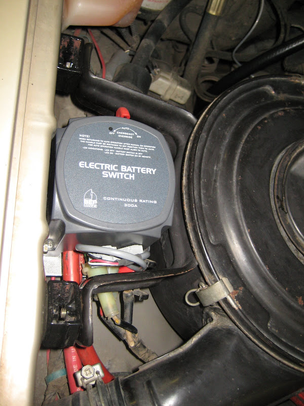

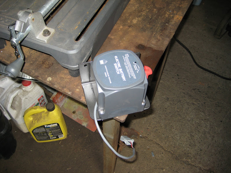

Took some time to get pics of the dual battery setup. I am using a BEP Marine VSR (voltage-sensing relay). Note on the pics, they show a battery switch with a similar hookup to the VSR, but the final install uses a VSR.
I used Marco's (Rover67) writeup on Rising Sun Toyota 4x4 Club * Denver, CO as a guide. It is nearly identical to my connections. I think the only minor differences are my starter is connected directly to the Main and the alternator is on the VSR +battery post.
My cable runs, battery locations, and VSR location were decided upon by how difficult it would be to modify existing wiring and make new runs. The 1HZ starter is on the driver's side so my Main went there (shortest distance). Likewise the factory wiring came out on the passenger, so instead of extending the "bundle" I just turn it all aft and connected to the +battery post of the VSR. The only added cables were a 1/0 cable from Main to +battery, and another 1/0 from Aux (+) to the VSR's "load" post.
VSR locating. Used a simple piece of steel channel with one side cut off for an L bracket(scrap on hand), also made two small spacers to push the air filter housing out about 3/4" All used existing captured nuts and Toyota fasteners.
mount bracket painted with Duplicolor Wheel Paint (Graphite). i am obsessed with that paint, it is great stuff. also rounded all the edges and corners near cabling

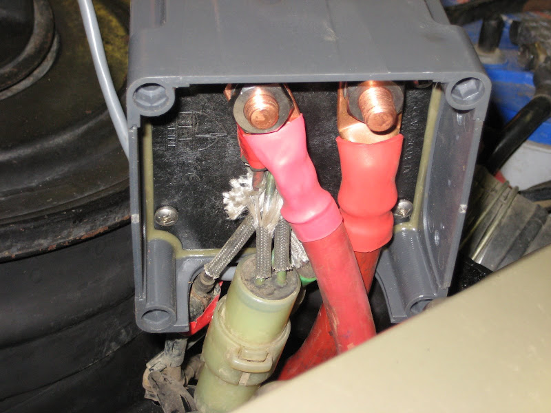

wiring.. 3 connections. had to hog out the oem connector a little. you can see the marine sealing of the VSR's housing

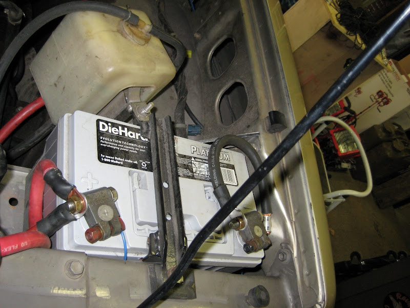

Main battery- G34 (32? forget now) Sears DieHard Platinum on stainlesstrays.com tray, my cables and military top posts from WranglerNW Power Products in Portland. oh and my fugly battery clamp made from scrap
Aux- was my main, a Blue Top Optima (same as yellow with extra top posts.. handy). Connections are VSR, wayne tangen's headlight harness, stereo amps, winch, accessory fuse block in passenger kick panel. Need to reroute the Main VSR cable more stealthily. VSR in background.
VSR installed. looped cable is the remote switch cable/connectors

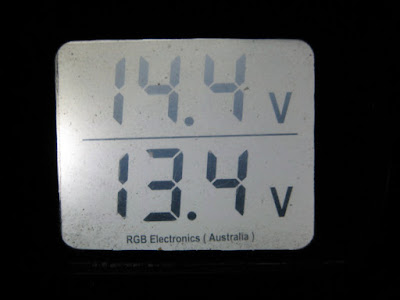

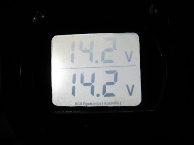

dual gauge showing Auto (voltage-sensing) mode readouts. top is Main, bottom is Aux
readout with VSR set to Off (isolate) mode

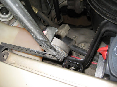

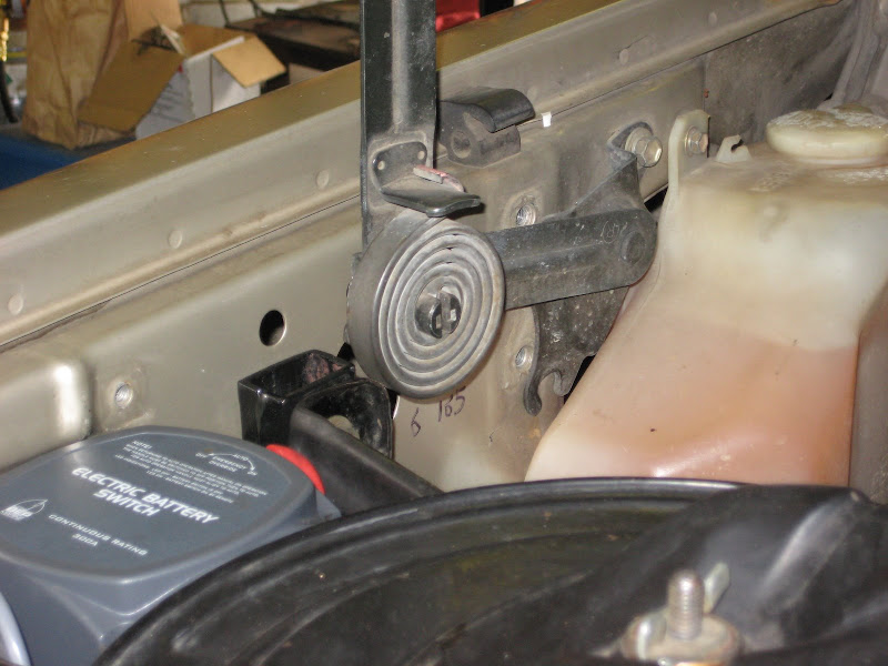

did run into a minor design flaw. the coil spring arm hits my spaced air housing mount now. have been meaning to swap to struts and design around it. note: fender panel has my last 3FE compression numbers behind the engine swap.. Cyl 6 was 165 before the engine was ejected. (cylinder #6 now has much, much greater compression :D )
another interference shot

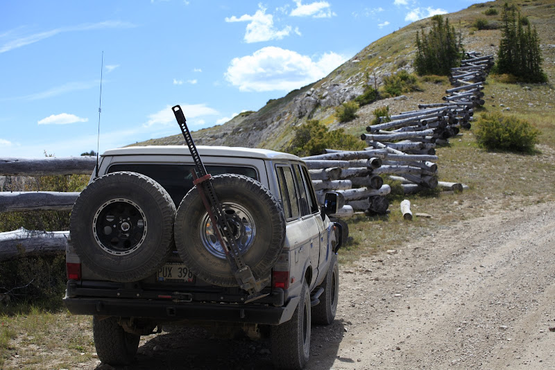

Got my 2nd tire carrier built for the 4x4Labs rear bumper. My welds aren't as pretty as Luke's.
Also got APRS up and going sporadically throughout the trip. I have the GPS module in my Yaesu FTM-350R. Also mounted the display above the rear-view mirror with some RAM mount bits. APRS is a good tool for friends and family- Location of KF7EOX - Google Maps APRS It works by sending the GPS coordinates (and other bits of info) into a global network. The Finland site picks it up and makes it available for mapping.
So, after 3 long trips this summer in a variety of challenging environments (technical wheeling Rubicon, altitude in Colorado, and dry/hot/dusty environments in Utah), I think the only problems I had was a busted shock mount and a fuse that had fallen out my fuse block preventing Sirius radio from working. ;) The shock mount was a bugger weld fix previously that a Rubicon boulder unfixed.
The sleeping setup is outstanding. I can stop anywhere, crawl into the back and sleep within seconds. It takes a little more effort with a passenger.
