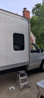

I've been slowly modifying over the last couple years. First thing was Koni RV shocks. The variable rate valving greatly improved the ride. Added two removable seats behind the cab using DOT approved materials and equipment. Installed a Maxx Air fan in the front of the box. Installed double pane low E side windows and Insulated floor, walls and ceiling.
The curb weight of the van is 5297. 3148 front and 2149 rear.
The basic idea was to make it work/play capable. Remove work equipment/ tools, load pre-packed camping bin kits. Goal was to make the transition in under an hour.
I've got plenty of thoughts and plans drawn out just not a lot of time to throw at it. Ideas of a hard wall wet bathroom/ composting toilet, small modular kitchen sink. Lithium battery bank with dc-dc charger, solar on roof and auto switch inverter for transition to shore power when available. Remove rear roll up door and replace with composite panel and double door.
