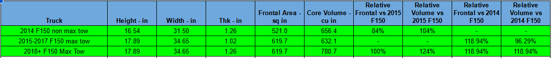

Ford didnt start using J2807 until 2015 at which time the radiator in the F150 increased in frontal area by 20%. But the GCWR of the 2015 F150 stayed the same as my 2014 at 17100 lbs and stayed there until the 2018 F150 got chassis upgrades and an even bigger radiator. So a 2018+ F150 with Max-tow would be a very capable truck with anything 10k lbs and under I would think.
You gotta understand too, I am towing is some pretty harsh environments(UT/WY/ID/MT at 6500+' in high temperatures) and, even though my trailer is pretty light, it has an incredible amount of aerodynamic drag. So when I'm cutting that thing through the air at 65mph into a 30mph headwind and its 95+ degrees out, my truck is having to run at 200+ hp non-stop just on flat ground. Once I hit a grade I am over 300 hp. And thats while getting 20% less cooling air mass through the radiator because I am at 6500'.
Not for nothing, but your 6.0 wouldnt even be making 300 hp in that environment. It'd be lucky to be making 275 hp and you'd be in the right lane doing 50-55mph with me in my Ecoboost. You because your engine lacks power and me because my engine doesnt have enough cooling.
But also, J2807 only says the truck has to maintain 45mph up the Davis Dam grade without any kinda of issues. 45mph is a pretty low bar. That's why 250hp half ton diesels get rated for 12000 lbs because they can just keep above the minimum speed.

Yeah the key really is radiator frontal area from my experience. Any trucks that are built for high load towing have really large radiators in height and width, but are not necessarily thick. Like the Godzilla 7.3L Radiator is thinner than my stock F150 radiator but dwarfs it in the height and width directions.
Problem with going thicker is it adds more resistance to flow, and the air that is passing through the deeper part of the core is hotter and absorbs less heat. So if you double the core thickness you dont get 2x the cooling capacity. You might get a 40% more cooling or something.
