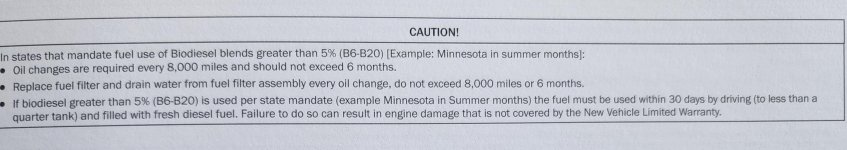

Relevant page in the pre-recall owner’s manual. So basically avoid B5-B20 but adjust service intervals if you have to run it, and no more than B20.
I’m very curious to see the new addendum post-recall. I know they now require a fuel filter change every oil change, instead of recommending it every other oil change.
It’s also complicated by “renewable” diesel, usually seen as R99 around here. Apparently this is more similar to petrodiesel in terms of lubricity, flow, cleanliness etc so requires no adjustment. But the pumps have to have a legal disclaimer saying something like “more than 20% biomass-derived etc” which can confuse matters between Bxx and Rxx fuels
