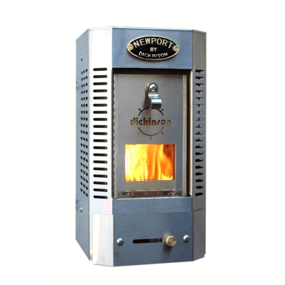

Perhaps a "romantic" Dickinson Marine "Newport Solid Fuel Heater"? http://dickinsonmarine.com/product_cat/solid-fuel-heater/
Yes, even with a CO detector, I'm a bit concerned with burning Propane, Butane, or White Gas inside such a small and tight camper. I love the Newport Heaters and the thought of having a tiny wood stove sounds like my kind of camping. I just can't imagine putting a chimney on my build. I think it looks great on an Alucab though.

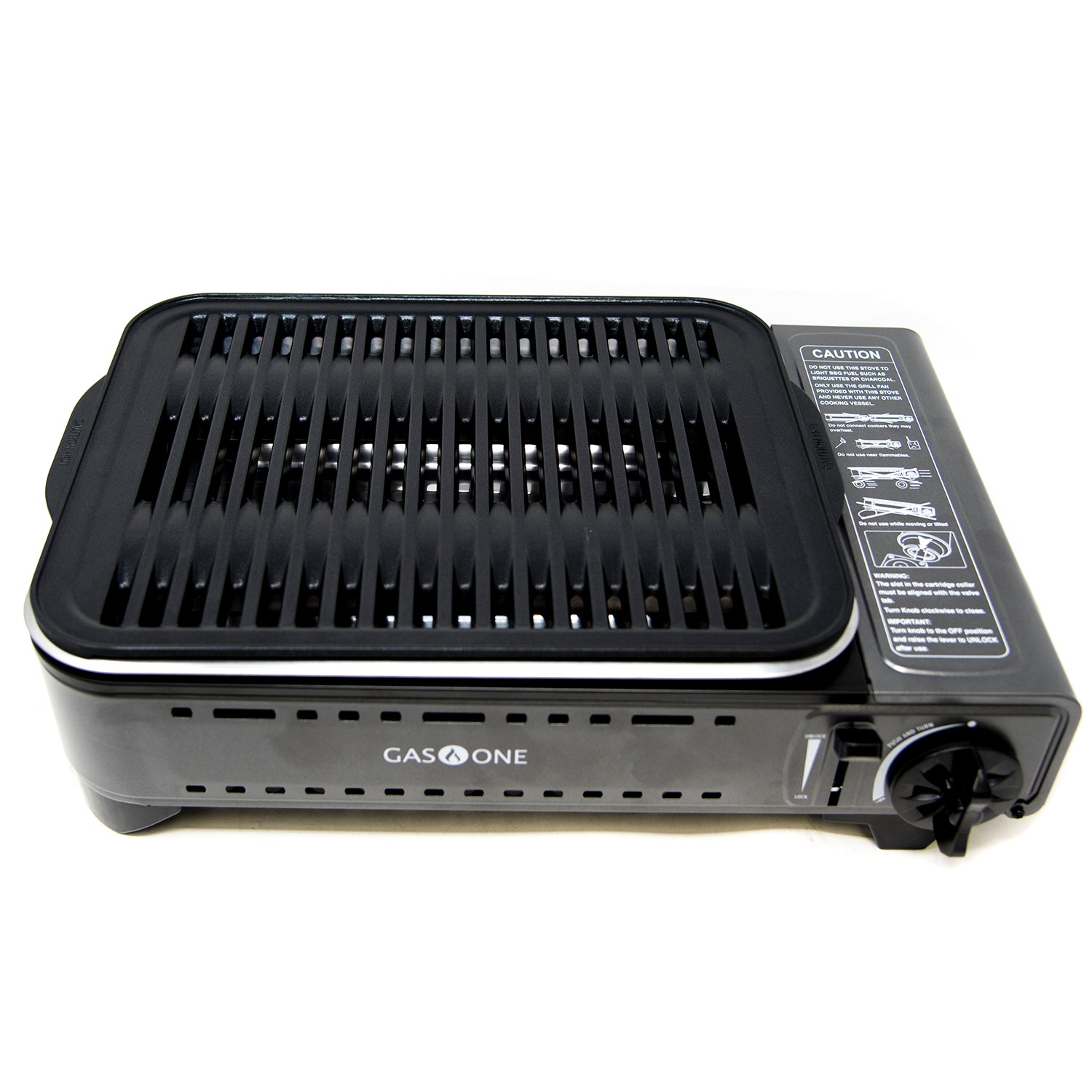

I have one of these and love it. Dual fuel so you can use your propane tank or a butane canister if conditions are nit right for propane.
Super stable and cheap. The reason I got one initially is because they have really good flame control.
The convenience of the butane is hard to beat. There is a lever where you engage/disengage the canister and it’s self contained.
Amazon product ASIN B083ZN1M3Y
I love them too but butane and extremely cold mornings don't go well together. It just does not like to flow like other fuels.
