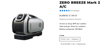

I saw my first portable A/C while in camping in Badlands. Have any of you purchased or tried a 12 volt AC unit yet?
During my trip, I ran into a gal camping with a 12v tent AC in the Badlands. This got me thinking about adding AC to my camper for the summer, but I already have AC in my truck. I haven't used the truck's AC for camping, because I assumed it would be terribly inefficient.
I Googled my efficiency question and it looks like my engine at idle will use about 1/3 gallon per hour. Looks pretty reasonable to me to run my truck in idle for AC in the camper. I still wouldn't run it all night, but just to cool it off in the evenings. The AC is pretty powerful and can cool off the camper in 10-15 minutes.
The back seat HVAC even blows directly into the camper.

Ecoflow makes one too.

We did this a few times with our minivan camper… just ran the engine/AC for an hour or two before bedtime. Lots less expensive to do that than buy a 12V AC for the few nights a year it’s needed.
I recommend having a CO2 monitor in the interior if/when you do it.

The combination of the two might be the way to go. Run them both to cool things down and then shut off the vehicle AC.
