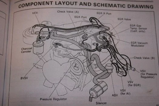

Oops, the sensor must be on the housing the EGR valve mounts to. It senses whether or not the EGR valve is working my taking its temperature. Well, the temperature of the gasses flowing through the housing.
Post 13 HERE shows where it is, sort of...
ETA: I don't remember where exactly it is...I'll post a pic tonight of my 3FE, which has the sensor.
No cel with EGR removal.
Yes you can just remove the EGR. Then cap the smog pump port on air filter and air line.

Now, Bomar, which ones are you talking about capping?
The two with the arrows?
