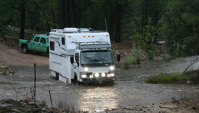

If we hadn't had Scott along prodding us to push our envelope, we'd still be sitting next to this Forest Service guy, who told Scott "I'm not crossing that thing!"
We were out there to learn the limits of ourselves and to learn, to the extent possible, the limits of the rig. Scott was outstanding at spoon feeding us experiences so that little by little we discovered that we could do a lot more than we ever thought we could, and that the truck is capable of much more than we will probably ever ask of it.
We would never have crossed even the small wash in the shot above, much less the big one in the videos, if Scott hadn't been there scouting them out for us. Now, having crossed a few, we know what we'd need to do if we were alone, how we would scout the crossing, rig for safety, etc., and most importantly, that we can do it and the truck can too.
And yes, there is something to be said for carrying around a good percentage of the weight of Western Civilization. The Fuso was completely oblivious to the current and still handled the other obstacles easily. To say nothing of being able to retreat into the camper for a warm and dry lunch during the downpour. I'm not sure Scott fully appreciated my radio call announcing we were about to start the rainy afternoon matinee action movie complete with popcorn. :chowtime:
We designed and built the Fuso to traverse "bad roads" in 3rd world areas. We know now that it will handle anything up to the point of its fundamental limitations, i.e. 16" wheels and low hanging pumpkins. It will take us down just about any market road we've ever seen on the GS and quite a few of the village roads we've been on. That's all we ask of the design. No jeep trails, but anything a local delivery truck goes down, we know we can get there.
Regarding the washes, if this had been a real world situation, we would have waited out the water. We had enough food and water with us to hang out in the forest for at least 2-3 weeks, and there were plenty of trails to explore on the bikes. The #1 killer of people on sailboats is forcing a passage due to an arbitrary schedule. We didn't have to be anywhere, so we would have waited until the water dropped.

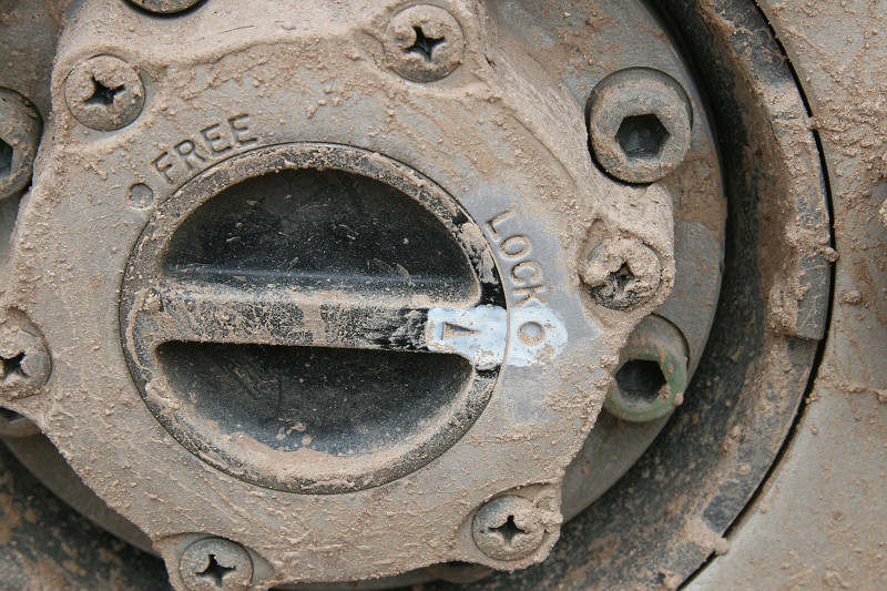

As to the hubs, I painted them so I could avoid just that type of Doh! situation, for which I am known so well...

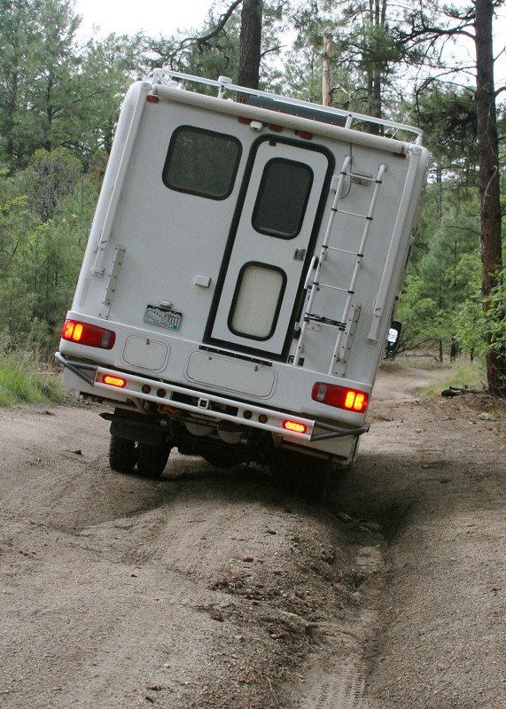

We made no modifications to the factory mounting system.
The camper sits on a 3 point pivot frame that is solidly mounted to the truck frame in the front and pivots at the rear. The pivot frame isolates the camper from any longitudinal torsional twisting of the frame and enables full aticulation of the chassis, and resulting twist of the truck frame (lots), without loading the camper itself with those forces.
We use the four stock tie down points. I did not reinforce them, although I have often wondered if I should have since their backing plates in the camper itself seem pretty miniscule cosidering the loads we put them under.
However, what we've discovered is that the camper and its contents have a pretty cushy ride. Steph rode across town in Ceder City, UT in the camper and reported "nothing moves, nothing squeaks, nothing rattles." We've discovered that we can leave our soap in the soap dish in the shower regardless of the road or trail and it stays put (even in the shot earlier in the thread where the camper is rolled to the max of our comfort level).

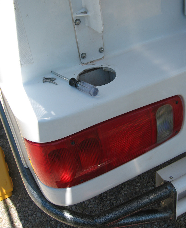

Here's a clue on how the camper and its content ride. We pulled into a campground in Idaho and within 60 seconds the inevitable began: "What is this thing?" etc. The wife of the couple circled the rig. She stuck her head around the side and asked me "Are these yours? Did you leave these here?"
It was the driver and four square head screws that hold our stock LP compartment door shut that I'd taken out and laid on the back bumper when we were at the LP fill station 65 miles back. About 35 miles of that was over a very rough, frost heaved, potholed and cold patched two lane.
So, maybe we don't need to worry so much about the camper mount...
I attribute 90% of this to the 3 point pivot frame 50/50 shocks, the custom rear sway bar, the custom Deaver springs and the Bilstein shocks.

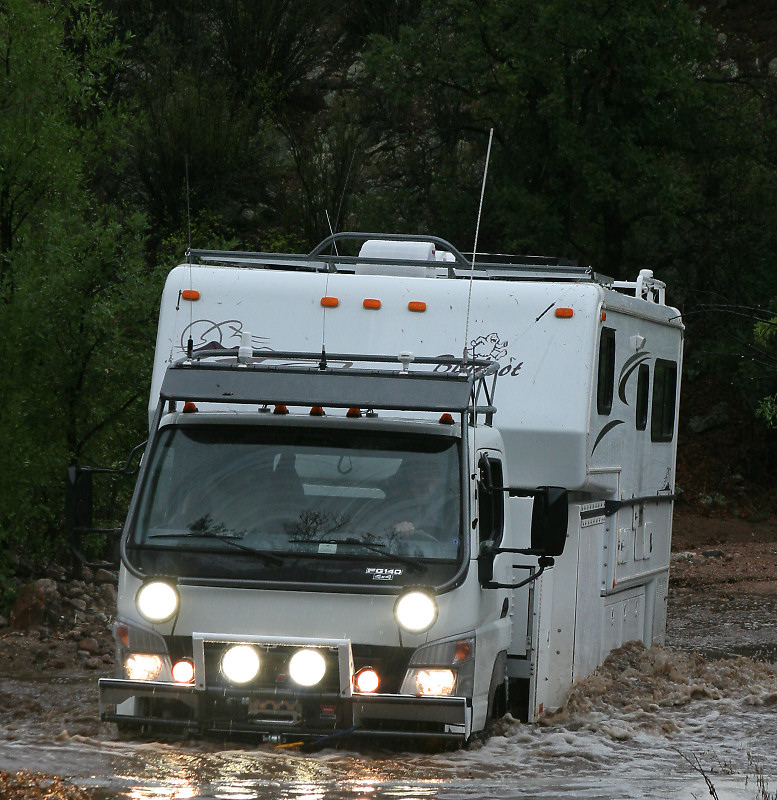

I did some measuring today so you would know how deep the crossing was for Scott's Taco.
Our lower rub rails at the rear axle are 37" / 93.98cm high (this rail is submerged in the following shot)
The hinges of the upper storage boxes at the rear axle are 39.5" / 100.33 cm - 1.003m high (the hinges are submerged in the following shot)
The pressure wave formed by the current against the side of the upper storage boxes on the Fuso is ~ 46" / 116.84cm - 1.168m high.
BTW, we unloaded, re-organized, labeled, etc. all the storage boxes today and we did find some moisture under the liner pads in the forward lower upstream box (submerged in this shot), so there was a little leakage there. The upper boxes in this photo were all dry.
