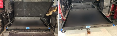

I've been working with MORryde on a cargo slide; it's for the JKU and JLU Wranglers and the Bronco. It also installs in the Ineos Grenadier (hey, now that I've got a Grenadier, I'm not going to miss an opportunity to adapt something to it). In the JKU:
The TJ/LJ isn't on MORryde's radar for this slide, but I figured if it can be made to fit there too so much the better, so I tried it in my LJ today. Turns out if fits great, it's basically full width in the TJ/LJ. Since I haven't installed the slide to the floor, in this next photo showing the slide extended I'm supporting the tray with my camera tripod...
LJSlideStowed.jpgFor the JKU/JLU/Bronco MORryde's doing a no-drill kit and I haven't shown them these photos yet but they don't have plans to do a no-drill kit for the TJ/LJ; even without no-drill kit it wouldn't be hard to do some nutserts in the floor to secure it using the holes that are already in the slide's mounting brackets.
They say their price target for the slide is around $330 and plus the no-drill kit for whatever vehicle they're shooting for less than $400 total price, but if one were to install the slide in a TJ/LJ with nutserts you'd avoid the cost of the no-drill installation kit.
I wonder if there's enough demand for this in the TJ/LJ market to make an installation kit worthwhile? The TJ/LJ don't have really usable tie down points in the bed so a no-drill kit might be a challenge to design but I think it could be done. What do you guys think? Worth pursuing?
View attachment 876221For the JKU/JLU/Bronco MORryde's doing a no-drill kit and I haven't shown them these photos yet but they don't have plans to do a no-drill kit for the TJ/LJ; even without no-drill kit it wouldn't be hard to do some nutserts in the floor to secure it using the holes that are already in the slide's mounting brackets.

I would definitely be interested in just the slide.
The other day I texted MORryde about this slide for the TJ/LJ market because I posted it on the WranglerTJ forum and there seemed to be a lot of interest in it there even with people knowing that MORryde probably wouldn't do a mounting kit for hte TJ or LJ so mounting would be up to the buyer . MORryde's reply:
We could do preorders for anyone that wants one and offer free shipping and $299.99. That would be just for the tray and no hardware or brackets. You can give them this email if they want to preorder: AftermarketSales@MORryde.com
If we get enough interest, it would take likely 3-4 weeks before trays are ready to ship.
MORryde said "just for the tray and no hardware or brackets", which is just what you want for the TJ/LJ anyway - the JKU, JLU, Bronco and Grenadier require additional brackets but as I posted the slide should be able to be installed in the TJ/LJ without too much effort.
A preorder price of $299.99 with free shipping for a large and heavy thing like this is a killer deal. I hope some of you can take advantage of it.
