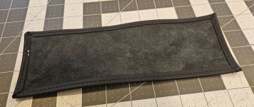

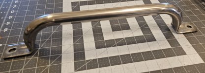

Something I've wanted to try for a long time is leather-wrapping, I've think I've wanted to try this since I had a leather-wrapped Laredo grab bar in my '83 Scrambler years ago. I finally tried it over the holiday weekend. I started with a plain CJ grab bar:
I made the wrap from a piece of leather, it's rectangular and I hemmed all four edges on the sewing machine, this is a view of the back side:

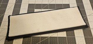

I added some 1/4"-thick foam to the back for padding. I attached it with 3M 77 Spray Adhesive.
While had the adhesive out, I sprayed a little on the top side of the foam to provide some grip on the bar to prevent it from slipping around the bar in use.
I sized it so the edges would not quite meet when wrapped around the bar so they could be pulled together tightly with hand stitching. I started at one end by stitching the ends together and pulling tight so they met, then I went along the bar putting a stitch under the thread of each stitch of the hems. Using the hem stitching as a guide provides for even and consistent hand stitching. Normally I'd use black thread to close the wrap, but for this first try I used tan so I could easily spot any imperfections and learn from them.

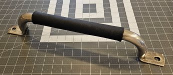

The finished grab bar:
I kept the leather wrap fairly short, avoiding the curves at the end of the bar, which made the wrap simple. Next I have to figure out how to pattern the leather so it wraps nicely around curves.
Materials used - a packet of leather remnants from Hobby Lobby ($5.99, I only used one small piece of the many in the pack), 1/4" foam which I've used in the past to line insulated bags, black and tan thread. I did the black hem stitching with v60 polyester thread because it was in my machine and the tan thread for the hand stitching was a little thicker v92. The v92 would also be better for the hems so when I do my next leather wrap I'll use v92 black thread, it'll provide for a stronger joint than the v60.

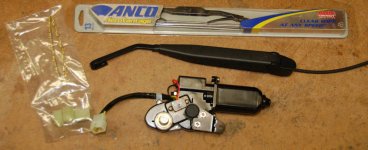

The motor I used is from AM Equipment, it's their 212-series motor: https://www.amequipment.com/shop/212-series-dc-gear-motor-assembly-and-208-replacement-3a2kl/, specs are 12v, 100-degree sweep, 25mm shaft. The wiper blade is 13", and the geometry looks like this:
For my Jeep, I used some Trico parts to make a custom wiper arm. Before Gr8Tops decided not to offer the wiper as an option, I was working with the AM Equipment on a custom arm for this application, it's in the photo below. I didn't go any further with AM Equipment when Gr8Tops decided not to offer the wiper option so if someone wants to put a wiper in their Safari Cab rear door, they'll need to work up a custom wiper arm like I did. The dimensions and bend angle are shown in the drawing above, it's not really that hard to make.
The wiper motor goes inside the bottom cavity of the barn door as shown in the diagram above and the photo below; the photo is a work-in-progress photo taken as I was installing the motor. One thing not shown in the photo below is the cavity cover, that was a separate piece molded in fiberglass so that's something that would need to be made if someone wants to do this project.
