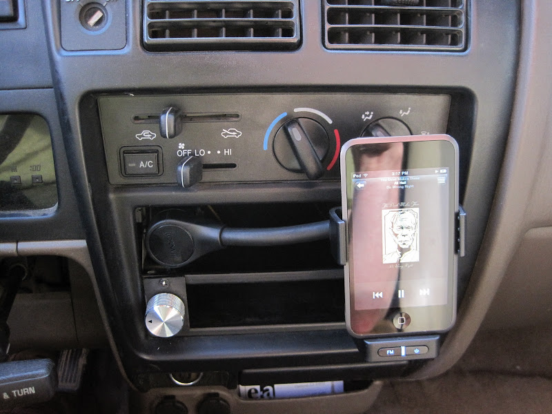

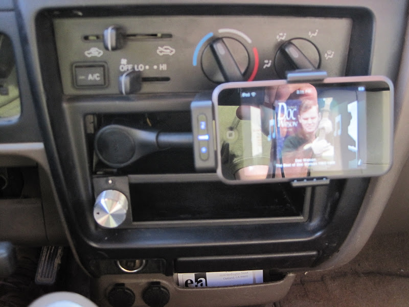

I just came up with this solution. Tore out the stereo, which barely got used, and welded a recessed lighter socket to the radio bracket. I had to reinforce the bracket so the socket doesn't move on bumpy roads.
I got this XM iPod dock for xmas, which turns your ipod touch or iphone into a sweet XM/Sirius radio receiver. Even without the subscription, it's a pretty good mobile cradle, as it has a dock connector with FM transmitter and line-level out. Not sure whether XM has programming worth $10/month to me.
It swivels for portrait or landscape mode.
Here's the ugly stuff in the stereo mount. I added the volume control knob, it's just a potentiometer from Ratty Shack. Nevermind the blingy knob, it may need to be sprayed black:
To a thief, it looks like the radio has already been stolen.
The gooseneck mount is pretty stiff but it might still be a little wobbly for rough roads, so I may add velcro to tie it to the dash.
I don't think I'll miss AM/FM radio, but if I do there are plenty of apps that can stream radio over the 3G network. Or I can bite the bullet and pay for XM.
