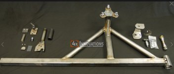

My custom rear bumper gets an addition
(paid a extra $50 to get the Isuzu bolt pattern custom cut)
Note: I need three propane tanks. One is stored in the propane compartment of the habitat, with external door and ventilation. For the other two. I found a 20 gallon propane tank designed for horizontal mounting. It seems exactly the same as the vertical mounted one with one exception.
It has a three hole mounting pattern on welded brackets.
Theses seem to be a mirror image, if two tanks were mounted to each other.
My consideration is to fabricate a bracket to weld to the swing away spare tire tube. To hang theses next to the spare tire.
