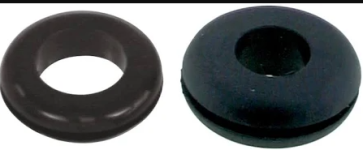

Its time to wire my rear bumper for lights.
My bumper has no holes yet. What is good practice to drill the hole for the light wire and protect the wire from the metal edge after drilling?
Would a over size hole allow the wire to be far from a metal edge?
Rubber grommets are the normal method to protect
Adel clamps to protect/support/limit movement.
Zip tie bases are a popular, easier option to Adel clamps (not as many sizes are needed)
