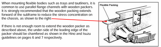

I'm trying to understand this "Flexible Packing"

As of this moment my design approach is in the first picture
As I understand it, the idea is to inhibit, or better still, completely eradicate fretting corrosion. When we were having our camper built in 2009, we intended to place it atop a steel tray. Being steel to steel, fretting would certainly occur, the slide-on camper manufacturer suggested we use a specially treated timber spacer to virtually eliminate fretting corrosion. We did, and it has been successful.

The last picture is the most important one for you. There you can see the flexible packing between the chassis rail and the steel tray frame built by our second stage truck manufacturer, which in this case was All Terrain Warriors. With Isuzu in Japan, being the first stage manufacturer.
