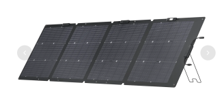

To maximise my solar I have two solar MPPT controllers, (1) four 200 watt panels (2) two 100 watt panels.
Additionally I have the wiring external next to the storage box for external solar panel arrays.
