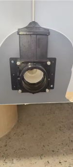

I'm installing this. What is best practice to attach the tube end to the grey water line? What do other builders do? What water line tube attachment methods do they use?
Riv nuts in a pieces of aluminium sikaflexed to the sandwich skin.
The objective is to spread the load and reduce any stress concentrations. The bigger the load, the larger the surface area required.
