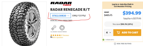

128Q is 1800kg maximum load depending on weight, on the rear axle you may be tight
Thanks i'll be underweight . The rating on the rear is 3970 lbs a tire. So 7940 lbs on the rear. By manufacturers spec.
Currently I'm at 1800 kgs with the habitat "dry" - this is according to manufacturer
A tire marked "128Q" has a load index of 128, meaning it can support a maximum load of 3,970 pounds per tire, and a speed rating of "Q," indicating it's safe for speeds up to 99 mph.
The truck empty is 5900lbs
Due to crew cab the truck is 55% front, 45% rear weight distribution.
The habitat due to the cab over bed is 55% rear, 45% front weight distribution, and that changes with water tanks full.
Can I guess I have an extra 1800lbs of payload over the rear axle?
I'm going to build a storage compartment between the rear bucket seats and store heavy stuff there as practical.
