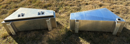

Trying to get this tank installation correct. Can anyone comment??
What do you want comments about?
Ask specific questions if you want other people's opinions.
One comment I would make immediately is that if the image above is your goal, be prepared to wait a very long time for any fuel transfer being done through a 3/8" fuel line.
My fuel transfer pump has a flow rate of about 20L/min with 3/4" lines, which is okay, but it's still not fast.
Thanks, I did get the comments I was looking for
I guess, it is time to make and eat a sandwich, and listen to a few songs.
