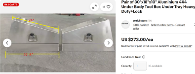

I need a front bumper and winch tray
I look at this one, cutting it in half and sectioning 5 inches out of the center. I need a width of 81-82 Inches about.
Then welding it to a heavy duty winch tray, and fabricating bumper brackets

As my colleagues told you, if you are going to modify it, I don't see the advantage, considering that the material is not the most expensive if you know how to weld, I don't understand why not to do it to your exact measurement in 3mm minimum.
The above are new not modified. Available for purchase just recently
A few months ago I bought aluminum rear fenders and I would need to fabricate mounts for theses. Using theses storage boxes, and the mounts for these I could integrate the rear fender mounts and save money by one set of mounts.
As far as the length, they work
