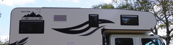

There are two separate double bed sleeping spaces.
Only one is over the truck cab.
( the dimensions were my choice to lower the mounting height on the habitat - and there is a huge roof hatch above bunk bed)

All decisions on a habitat build come with compromises. The tall cab height and the effort to keep the total rig height lower forced this space in the upper bunk, one can sleep there and turn over without obstruction. Some folks need more head room and have a second option to sleep on the other bed (which can accommodate a 6ft 5 inch sleeper). The huge sky hatch opens up lots of room over the bunk bed.
I've measured head room space on some others like the Earthroamer and it is only 100mm more.
And what the Earthroamer does not have is the shorter rig length by 36 inches
(the engine under the cab changes the proportions)
The Australian version has 30mm more head room, and no big sky hatch.
(I also made my bunk length 80mm longer than the Australian version to account for the roof slope)

Other builders have compromised on head room too (mine is one inch less than this)

Certainly. Especially true when there are two of you and your trips are long term. Based on my guess by scaling your photo, you have ~20-22" vertical in that sleeping berth... without a mattress. Is that about right?

26" with a big mattress.
