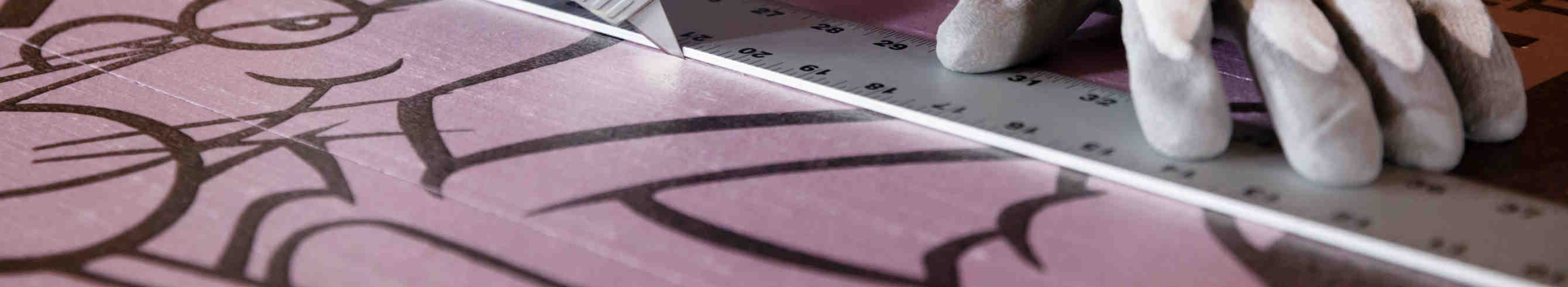

Not sure why that didn't show for me. Glad to see I can get it as it will provide a more uniform surface than spray in foam. My plan is to use this to build a thermal break. my frame is only 1.5" so this will cover the frame by 1/2". This assumes I can easily transfer the frame outline onto the foam so I can cut the foam so the frame inserts into it.
... Not sure why that didn't show for me. Glad to see I can get it as it will provide a more uniform surface than spray in foam. My plan is to use this to build a thermal break. my frame is only 1.5" so this will cover the frame by 1/2". This assumes I can easily transfer the frame outline onto the foam so I can cut the foam so the frame inserts into it.
Owen Corning makes a wide range of "Foamular" rigid foam insulation 4'x8' sheets. There are many different thicknesses and different densities. The hard part seems to be finding them locally if you don't want one of the few products chosen for the local store. :(
You might be better served with 1.5" thick 4'x8' sheets. The following product doesn't seem to be available in your area, but, I've included the link as an example:
Owen Corning Foamular link:
Check your local lumber yard or siding wholesaler… the guys the professionals get their materials from. We have a place here called darragh that sells everything besides concrete for that line of work and I believe they have some rigid foam options… ask for a discount and you may get one
Man the 1.5" would be great because I could put it between the frame rails and then put 1/2" over it and the frame rails to get my thermal barrier. I guess it was too great a solution to actually be available!
Good idea. I know some people in the industry I can ask.
Man the 1.5" would be great because I could put it between the frame rails and then put 1/2" over it and the frame rails to get my thermal barrier. I guess it was too great a solution to actually be available! ...
There is a lot of it local to me, but, that doesn't help you out at all.
Try the Lowe's version, see if a local store has it, or will get it, in stock:
