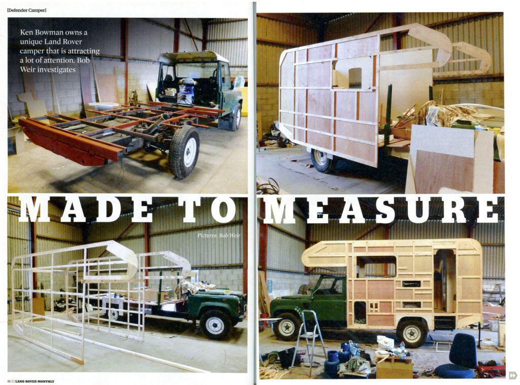

Unlike Wranglers, which have a one-piece tub, Land Rover Defender/Series are built around what they call a "bulkhead" - the front clip bolts to the bulkhead and the doors hinge from it, and the rear body bolts to the frame behind that.
This structure makes it very easy to build new vehicle designs - just unbolt the rear body and bolt something else in place.
Converting to a full camper is much more common with Defender/Series Land Rovers than it is with Wranglers for that reason. Here's one:
