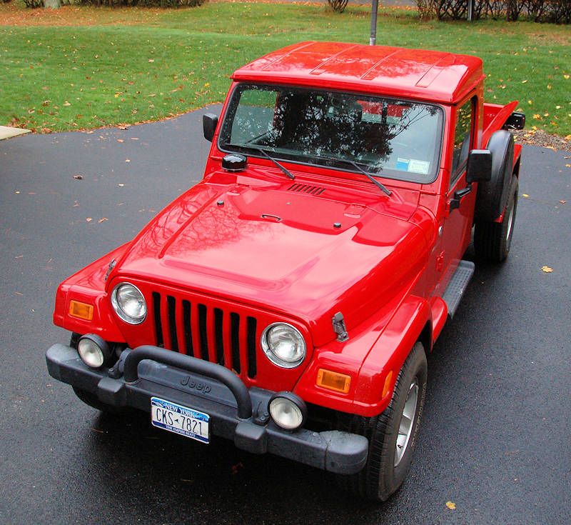

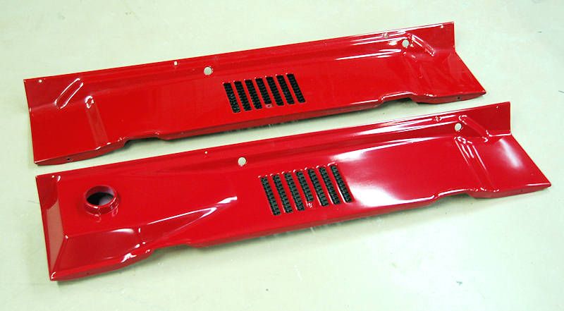

I don't like that pretty much all of the snorkel products on the market require that you cut holes in the Jeep sheet metal, so I did some work on a prefilter/snorkel idea for the TJ a few years ago that would not require cutting any of the external sheet metal - I created a mold for a cowl panel that included a provision for mounting a cyclonic prefilter. The new fiberglass panel compared to the stock panel:
CowlCompare2.jpg~original

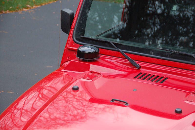

Testing it on my pickup:
CowlFinal30.jpg~original
CowlFinal33.jpg~original
The air intake gets routed through the firewall and there's ductwork integrated into the bottom of the new cowl panel to channel the air through the firewall. It worked very well, but since I don't drive my Jeeps into dusty areas like Moab more than once a year I didn't permanently install that panel and a prefilter on either of my '06's.
About a half dozen of the cowl panels escaped into the wild, two years ago a forum friend borrowed the molds and had a bunch made for himself and a few friends but other than that I haven't done anything else with the molds.
ive run pre cleaners or cyclones on all my snorkels on my jeeps, land rovers and Toyotas in New England and I can say with confidence that they do work well and keep so much debris and water out of the air box. I empty it every month and it’s amazing how much they catch. I have yet to change the air filter it’s still white.

Love this simple protrusion. So many of the others look out of place.
jscherb
For me, form and function are equally important. I started designing my own Jeep accessories years ago because it seemed that form played a poor second place to function in so many Jeep products and I wanted to elevate form to equal importance with function, at least for my Jeeps :)
