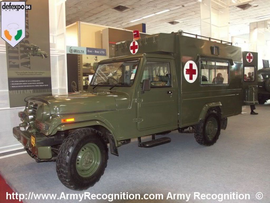

Every time I see one of these I wish Jeep had made an ambulance that could be converted to a camper.
Jeep didn't, but Mahindra did.
FieldAmbulance.jpg~original
I wish we had something like this in the U.S.
