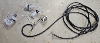

At $300 US, it's seems a bit pricey to me. Coincidentally, I've been experimenting with the same idea, but using much less expensive parts. Mine is just a proof-of-concept prototype, it's not finished yet, but it uses 4 clip-on Schrader chucks, a 4-way valve assembly, a Schrader valve for connecting a compressor (or letting air out) and a pressure gauge.
It works as expected, which means I can air up or air down all 4 tires at the same time, monitoring the pressure on the gauge. The cheap hose I first used is prone to kinking, so I talked to a hose supplier I've worked with in the past to find some better hose and he sent me a sample - that's the black hose in the photo below. The new hose is perfect. A smaller digital pressure gauge would be better for this application, so I'll source that and get enough of the back hose to replace the kink-prone clear stuff.
The initial testing suggests this could be very useful not only on the trail but also useful to synchronize all 4 tires to the same pressure so the JKU's TPMS system will show all 4 tires being the same. And a lot less expensive than the UK product. I believe there's at least one similar product in the US, but I think it is also kind of pricey.
My project has the interest of a compressor company and I'm meeting with them at SEMA this week to discuss this and a few other ideas I've got for them.
My big complaint with that setup would be the amount of space all that hose would take up. Seems like a lot of space to waste to maybe save a few minutes of time.
-Mike
-Mike
Mike,
I agree that's a concern, and that's why I first tested the clear hose which as you can see from the photo takes up very little space. Unfortunately that particular hose is prone to kinking so it won't work in this application.
In the photo I posted yesterday, the black hose is much too long, I didn't cut the sample they sent me, I just tested it at the length as it came. But even when it's cut to the proper length it will take up some space.
We'll see how much space it takes up when I get enough of the black hose to do all 4 tires and I cut them to the proper length. One goal I have is for it to fit inside my compressor bag, which has more space available even when it's got a 25' (!) long Flexzilla hose inside...
I've also got some ideas for a carrying bag just for the hose assembly that will store in minimum space, so if it passes the "fits in my compressor bag" test, after that I'll sew a prototype bag just for the hose assembly.
Still a work in progress.
