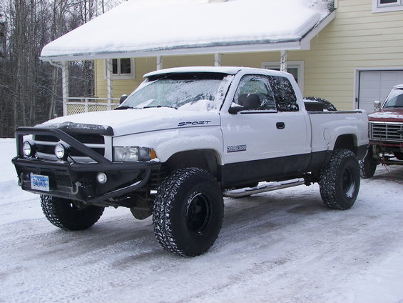

nothing like pulling an axle on the ground outside in March in Alaska.....cold. Thats Ok, I was swapping out the 10 bolt for a Dana 60 1 ton front end.

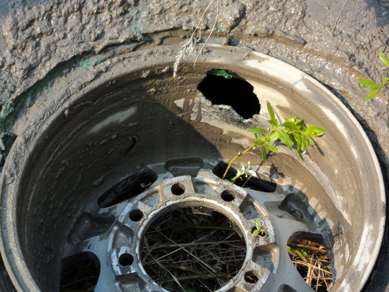

reason number 10 to run STEEL rims.............when I crossed that river on the way out a rock kicked up by the river went between my brake caliper and the inside of my rim......something had to give and it was my aluminum rim. I thought id lost a bead but didnt, I didnt even notice why I went flat untill I took my rim off and a chunk of metal fell out from the INSIDE of my rim.
