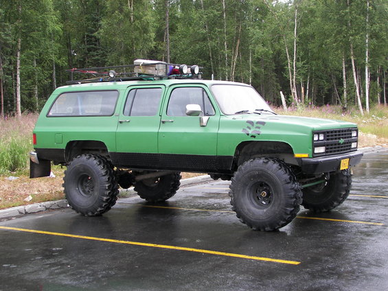

Thanks, I miss it. It went from a stock ex Air Force rig to that. 14 bolt rear end with Detroit locker, 5.13 gears, Dana 44 front with Chromoly axle shafts, CTM U-joints and ARB locker, Crossover steering, Heim joints.....I miss Her.
