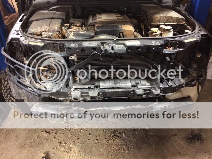

Great install write up! Im seriously considering this, but it looks to be a little more complicated for me. the A-bar bolts to the bumper cross bar you removed.
unnamed-1_zps0b82992b.jpg~original
So, the hidden winch needs to have the brackets to bolt the a-bar to. I think some do, but it doesnt look like the Terrafirma tray does. I think maybe the Devon 4x4 tray does - Do you still carry that one too?
WOW!! Good eye. Devon is no longer selling into the states and their mount will not work for you either.
IF I had your truck in the shop we would weld a bracket or cut the stock bumper bar and attach it to the Terrafirma tray.
