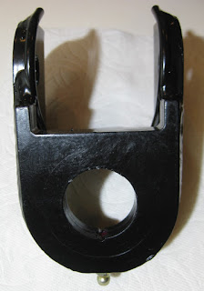

Note the area of the yoke's horizontal plate that has been machined out, about 1/2" ~ 3/4" deep towards the main bolt hole..
It was probably a design change to allow more downward movement of the trailer tongue to approach 90 degrees. The old design used to limit the downward angle like this:
The yolk part design doesn’t look durable. The MC i have seems to be the 2nd gen , according to the pics posted.
There’s no “bushing” that would take up the wear and no replaceable parts so it doesn’t wear into the hard metal part of the yolk. It’s easier to replace wearable bushing that are cheap vs replacing the expensive housing.
The metal yolk seems to be regular steel that would be dented if you hammered it vs heated steel that would stand up to wear a lot better, even with steel rubbing steel. I’ve seen aftermarket hitches with the pin hole elongated overtime due the rocking back / forth of the trailer pulling/ braking and I’ve seen Toyota hitches that’s heat treated it’s the perfectly snug pin hole regardless of the rocking /braking/pulling on the trailer.
From the gouging on the worn steel, looks like it’s soft steel as heat treated steel would grind the dust, etc into powder so it would not have those deep gouges in it, but a smooth worn area.
Luckily, I don’t tow my trailer as often as I hit the trail so it does not wear like yours but from the look of the design, I know it’s not going to last. Fortunately, I have friends with machine shop and welding shop so I could have them made Teflon or brass bushing to take the wear and possibly try to heat treated the yolk so it would stand of to grinding better.
I agree. Using the body of the yoke as a bearing surface is okay for a $50 yoke but not for $135 yoke.
Maybe re-designing the yoke for a real bearing that can handle mostly radial and some small axial forces?
Would a tapered roller bearing be appropriate?

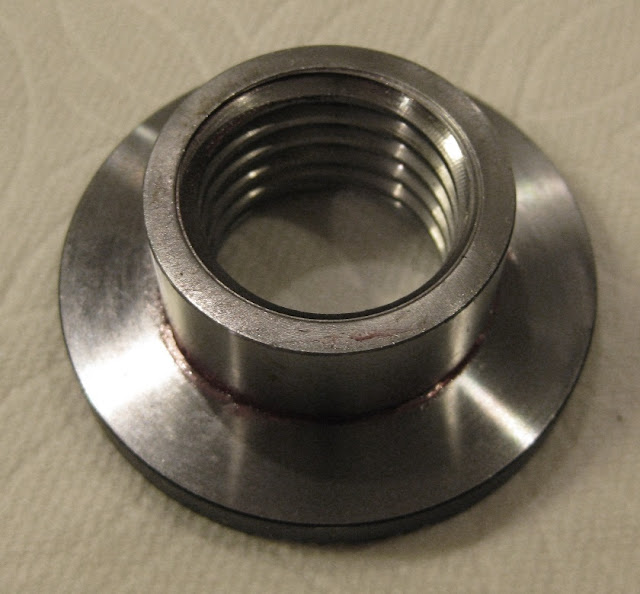

Why would CU Offroad call their solid steel (above pix) spacer a "crush spacer" anyhow?? It is solid and does not crush, deform or collapse such as those used in differentials.
Example of a differential solid spacer versus a crush spacer that is meant to deform
crush-sleeve-and-solid-spacer
************** marketing guy without good understanding mechanical terms ??
