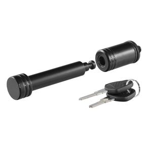

Another wear point I see is that the angled hitch pin is going to wallow of the hole it goes in to as it slides back and forth.
A straight, locking hitch pin is a far better solution to avoid a wallowed out hole.
Angled hitch pins causing wallowed out holes is a well documented problem on the OEM hitches used on GMT800 (99-2007) GM trucks
I think you mean one of these?
3
A straight non-locking might be like this
