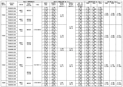

What’s the front axel weight? Thx.Here is a photo of mine, self-built, nearly complete.
About 8000 pounds; more than enough to support the weight up front.What’s the front axel weight? Thx.
I imagine 8000 pounds is the weight of the rear axle?About 8000 pounds; more than enough to support the weight up front.

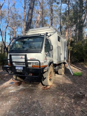

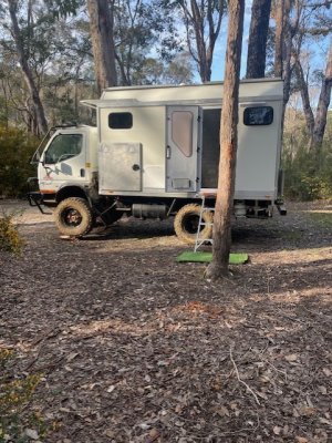

Canter 649, 2005, versión de batalla corta. Cabrestantes dobles, depósitos de diésel dobles, depósitos de agua dobles, ducha, inodoro, energía solar de 800 W, batería de litio de 400 Ah, inversor de 240 V CA.

Canter 649, 2005, short wheel base version. Dual winches, Dual diesel tanks, Dual Water Tanks, Shower, Toilet, 800w Solar, 400AH Lithium, 240Vac Inverter
