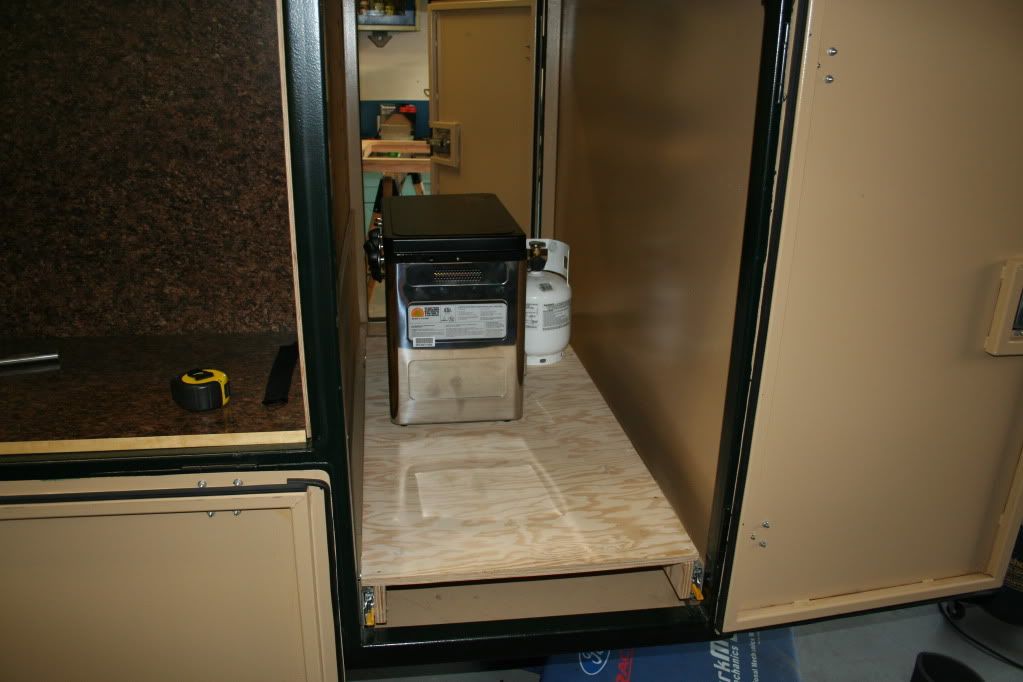

I've spent a bit of time on the trailer the last week. I got the kitchen slide installed.
The intent is to have the stove and a cooler permanently mounted to the slide, probably with a nice veneered plywood box around them or something like that. Really the goals is to have some kind of a heat shield between the stove and cooler, and also extra insulation all the way around the cooler. Also possibly a lid on top of the cooler so that it can be latched and at least be racoon proof.
For the cooler looks like we'll be going with a Waeco/Mobicool A40 tri-mode powered cooler. One of the absorbtion cycle devices that can run on propane. They're affordable, the propane option is nice, and they do work better than the cheezy 12V coolers. It's also really the only thing that fits beside the stove on the slide platform.
The only problem with the slide as I have it now, is that the door must be opened 180° to get the slide out. That is because of the way the door is hinged. It is a significant problem if a motorcycle is on the tongue. My only options are to change the hinges so the door swings more out of the way. Or, to narrow the platform a bit. I'll probably attempt option 1 at some point.

Rob, could you put a ply packing strip between the front wall and the kitchen slide? This would make the kitchen a little narrower to clear the depth of the door frame when open 90deg. You'd only lose about one inch on the kitchen depth.
Indiedog, that's pretty much my option 2. But I think it'd need to lose 2 inches to get it done. It's not the end of the world, but I'll see if I can do new hinges first. It's the slightly more complicated, but slightly better option, I think. But yeah, right now the brackets holding the slides are 2"x1/8" strip bolted to the frame, and I'd just need to change them to 2x2 tube to move that slide 2".
