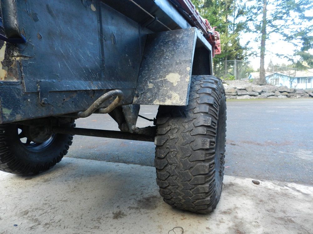

so I just went and grabbed 3 tires for 60 from a guy off CL. not a whole lot of tread, but enough for the trailer. about 30%. 33x12.5x15 interco m/ts. ill have them mounted and balanced tomorrow, and ill post some pictures of before and after. now I need to have someone weld me up a hitch mounted spare tire mount, and have a receiver tube welded to the rear of the trailer

lol well I will see how it works with them just dangling. if they don't hang too bad ill leave them there. I don't have the money to start a rebuild on the trailer axle right now.

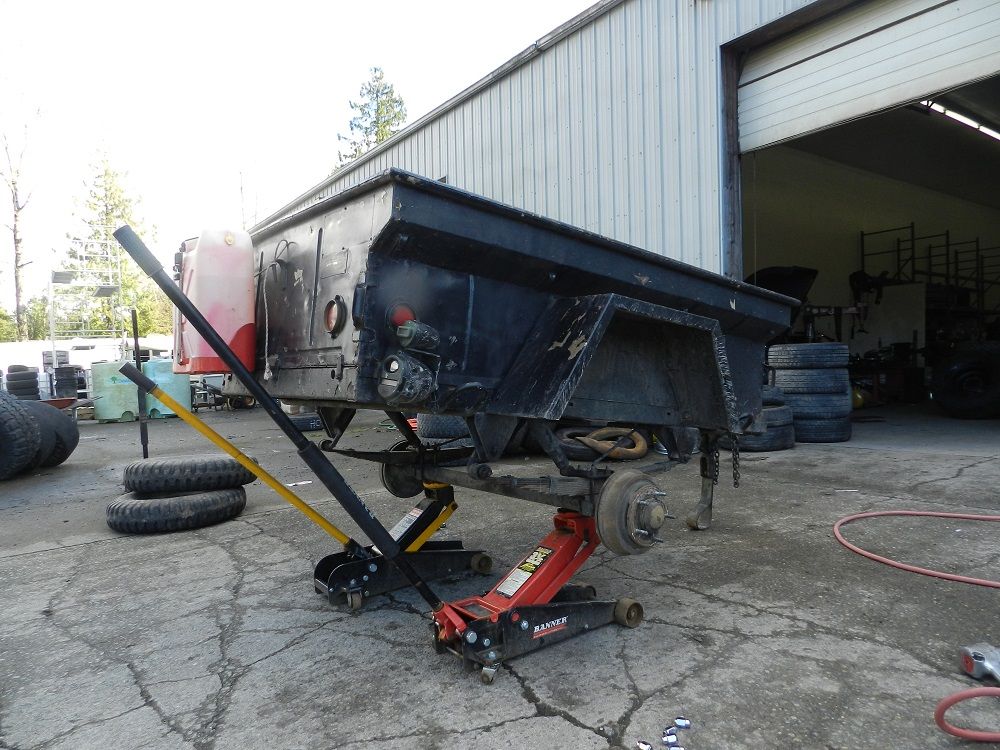

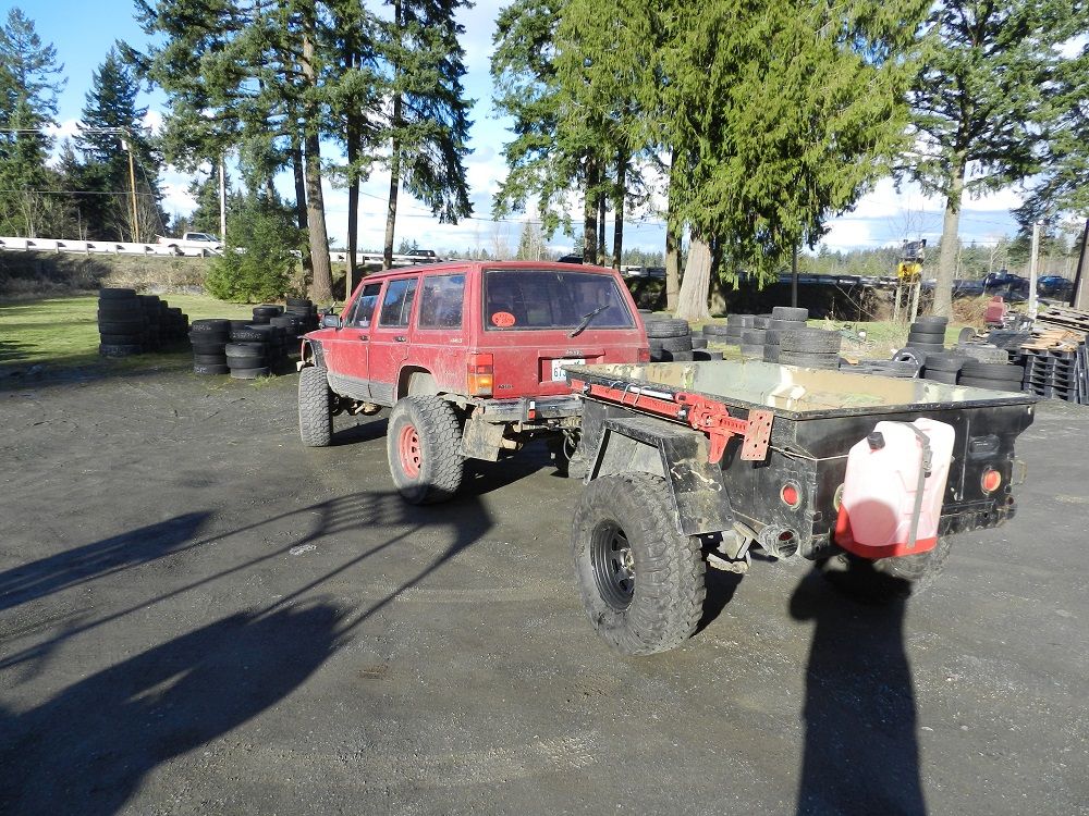

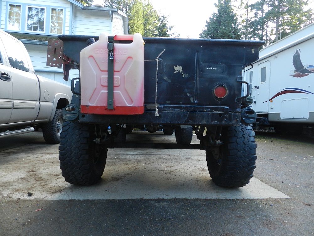

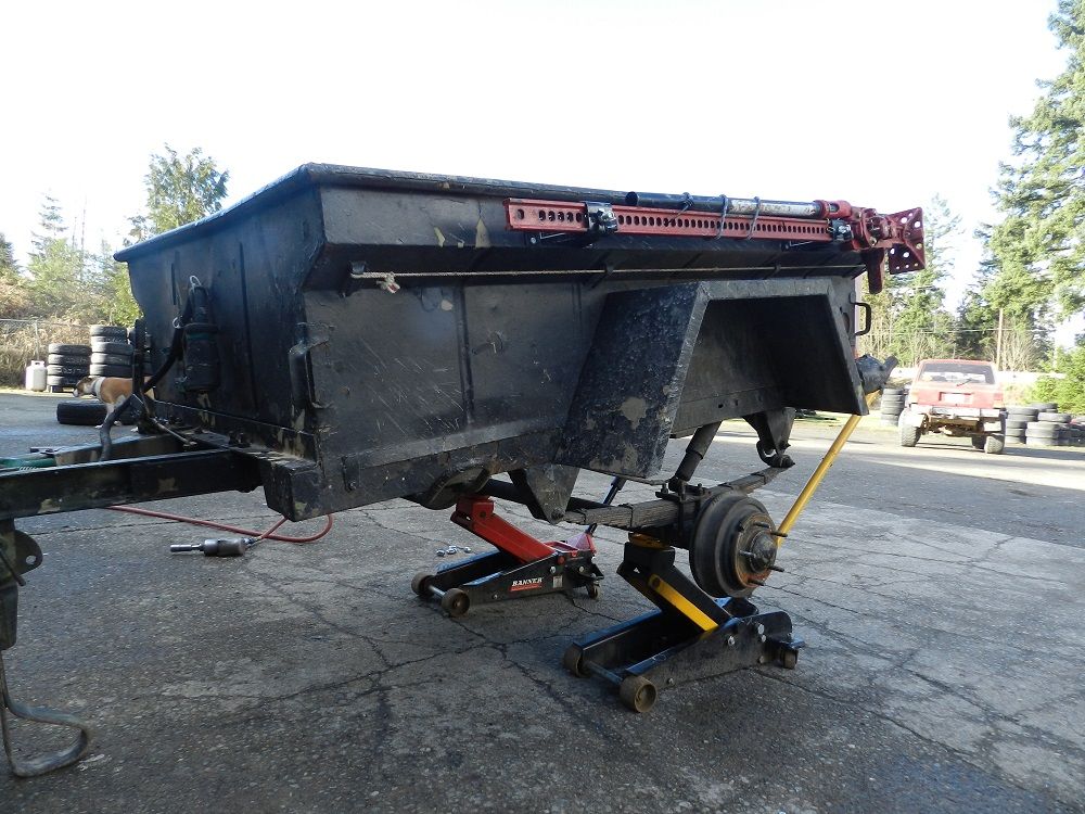

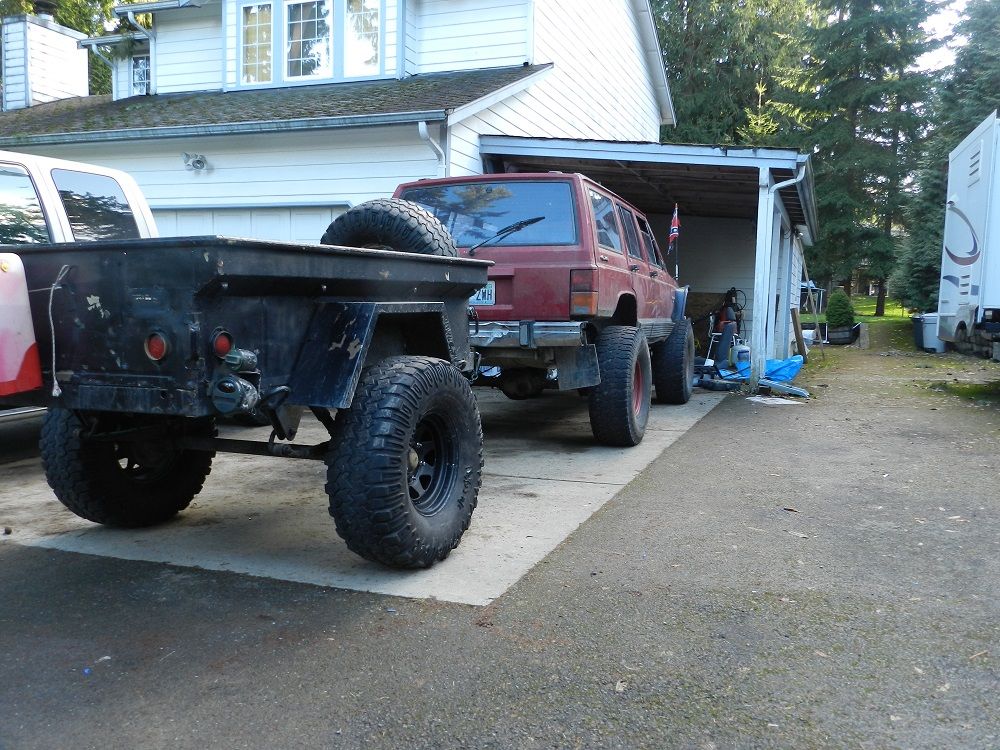

hey guys got the tires on. heres the pics.

Did you get the brake issue fixed, Once you do a springover you have to rotate the brakes 180 to get the attach point back on top. Just pull the hubs, take off the 5 bolts holding it, rotate and rebolt.
As everyone says, the original wiring is 24v. Just change the bulbs, go to wiring box on the tongue and get a harness from your truck (4 wire, 6 wire, etc) and tap in at the junction box. The wires are coded and the internet has the code for all the wires on the trailer. To redo the axle and brake is about 3-4 hours and the harness about 1 hour.

I got the axle figured out. just not the brake light issue. and the trailer is fine. its my jeep that's messed up. I don't know how to hardwire it without messin up the jeeps lights
