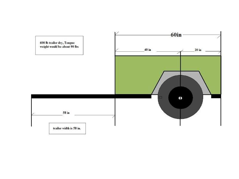

Need some help with my Trailer design

Here're a few rules of a thump for trailer designing:
-10-15 tongue weight as others have mentioned
-THe axle should be positioned in a 60/40 manner in the length of the tub
-The hitch to center of the axle=to your tow rig's wheelbase.(in order your trailer's track to be identicall to your towing rig's)
-For a tongue you can use a (single)straight tube an 'A' or a combination.
A lot of off roaders use a single because they don't want when jacknifing
their bumper to hit the side of the tongue.
I think all "A" tongue hitches come in a 50o set up and this pretty much dictates your tongue's lenght.

Of course as many other fellows mentioned "ALWAYS" a design is a compromise.
NO having all the above in mind you can just copy the provem m101CND
[/IMG] and have sometimes problems swaying and manouvering
(I've been driving a m100 in the Greek behind a G-Wagen)
Or take some of the features of this
[/IMG](better for not so tight trails)
Anyway you're driving a SWB Jeep and it wouldn't make along combo.
Whetever you go with have fun
George

So if my trailer is 60 inches long (the tub), then the centerline of the axle will be about 20 inches from the rear, 40 inches from the front, and the tongue is approx. the same length as the width of the trailer.
Is this about right?

I based my trailer on "the standard" too, why change something that works.
They put the wheel in the center of the box, so the load is spread evenly.
By the time you've added a full cooler, gas tanks or a battery box on the front you will have your weight distribution about right.
the mill specs posted earlier have a box length of 72"
and a total length of 114"
Thats a 1.58 ratio box to toungue..
so if your box is 60 your total length should be 94.8 giving you a toungue 34 " long.
That is if you want to give yourself a similar set up to the standard military trailer.
adding a few inches to the tounge won't matter that much, its just a question of balance.
Right now hitch to axle is too long, and too much weight on the hitch, as you will most likely fill that 58" with gear.
Here's mine basicly a balanced design if evenly filled with gear, water tank is forward of axle- battery is aft.
I'll be adding a 4 can holder in front of the box- giving me some weight on the hitch

Dunno if it helps you or not but the box on my homebuilt work in progress trailer is 72"Lx48"Wx19"H and the tongue is 48" long. With the hitch a 48" tongue length clears the side of the truck is case of a jacknife. The edge of my rear bumper to the center of the hitch was right about 36" so the tongue gives me a little wiggle room. I think 58" would be way too long.
Also, I have my axle 2" rear of center on the tub. Only gauge I have at the moment is moving it around the garage by hand. It balances well and is easy to move. There is a slight weight bias toward the tongue and with gear I think it will be about right. I'm no expert but just sharing my experience so far.
