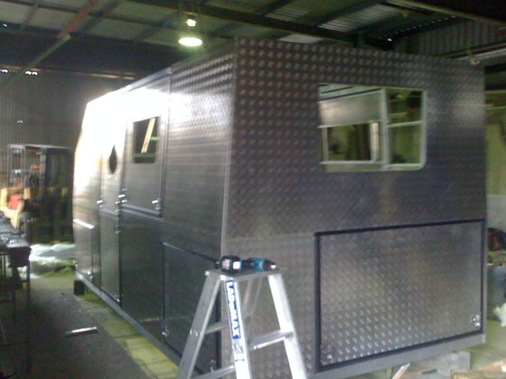

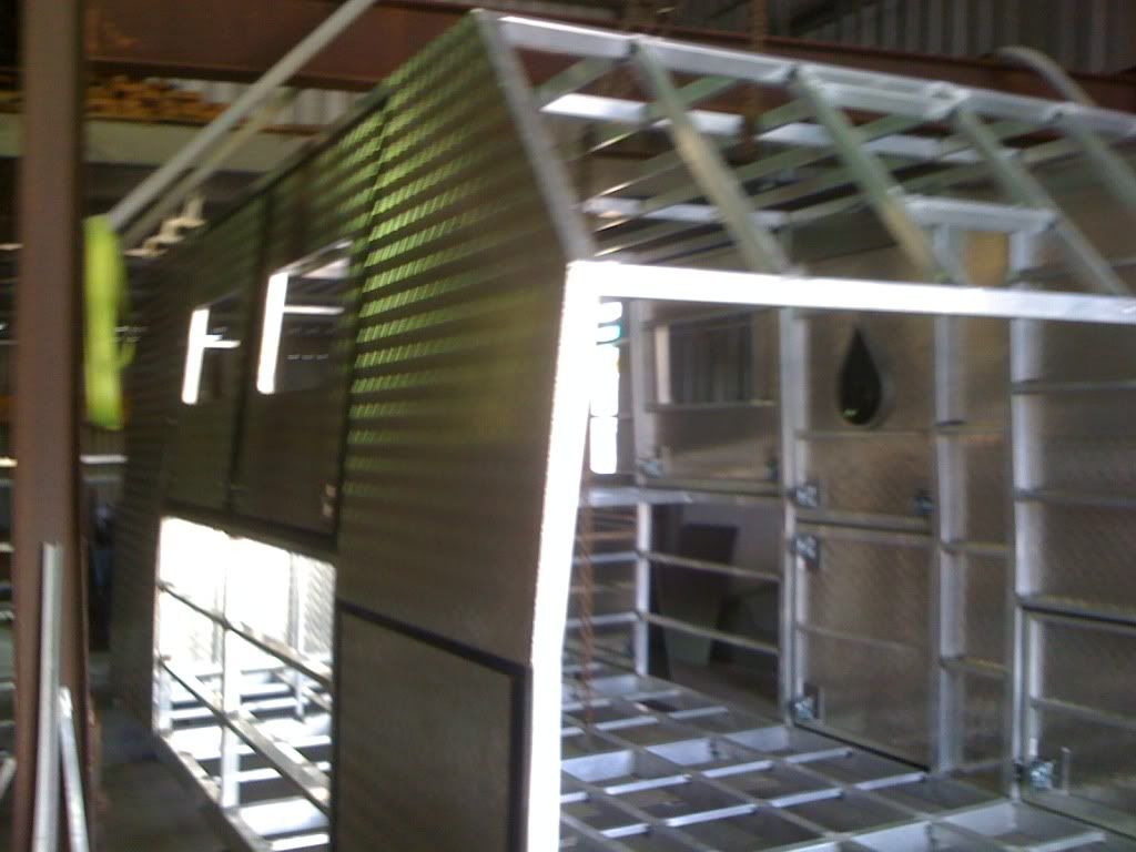

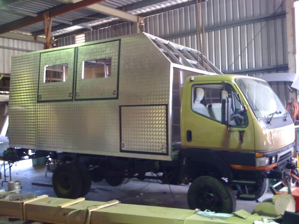

been hard at it but coming together...
on my second box (500) of 3/16 rivets....100's of holes drilled:Wow1:
will mount camper on truck next week and then finish floor and front paenel
few pics...more to come...

Gee Billy , Lots of cool ideas there. Is that a split door, half hinging up and the other half down? And is that hinging panel with the window in it over the galley? Generator bin rear left corner?
Oh and where did you get that tear drop window? Out of an old '70s Sandman panelvan? Haha.
Well done anyway.
oka boy
Great work Billi!,what are you using for insulation?,will you have a lot of heat transfer though the ally?when can we have some photos of the inside?
great work!!:wings:

Awesome!!!!!! Love the Ali, but you'd better paint it with something before you venture out into the tropical sun with it. I can't even stand on the roof of our trucks without footwear. With the painted ones, i can dance from rag to rag......
But it looks cool!!!!!
