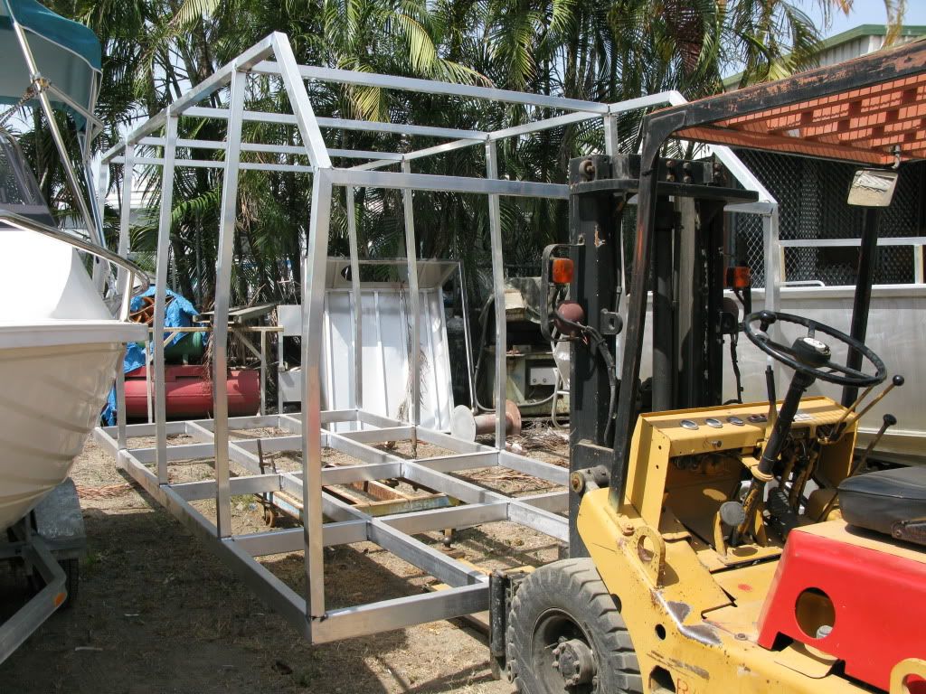

Been real busy last few months...
Camper nearly built...and....
truck chassis and cab painted....
so will be going back together shortly...
a few pics...
a few specs...
4600mm long, 2300 wide, 2200 overall height ( 2050mmm floor to ceiling
chassis built from 100x50x6 mm alli, rest built from 50x50x3, and framed in with 25x25x3 and 25x50x3 (walls and roof are 50mm thick)
roof sheeted with 2.5mm checher plate, walls 1.6 and floor 3mm flat plate...
will post about solar set up, water etc soon...:Wow1:

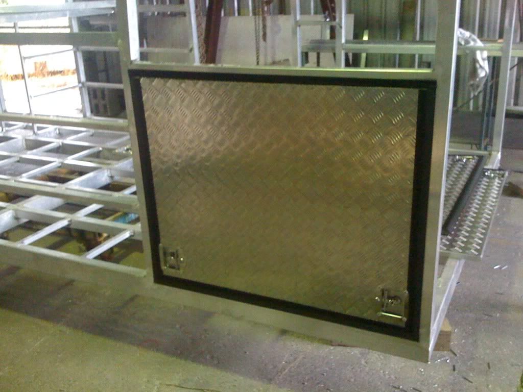

sheeting just about to begin,
finished doors and other openings - 9 in all...18 locks, all keyed alike....35 spare keys...hehehe
full dust sealed doors and waterproof plastic hinge (expensive) used throughout...
