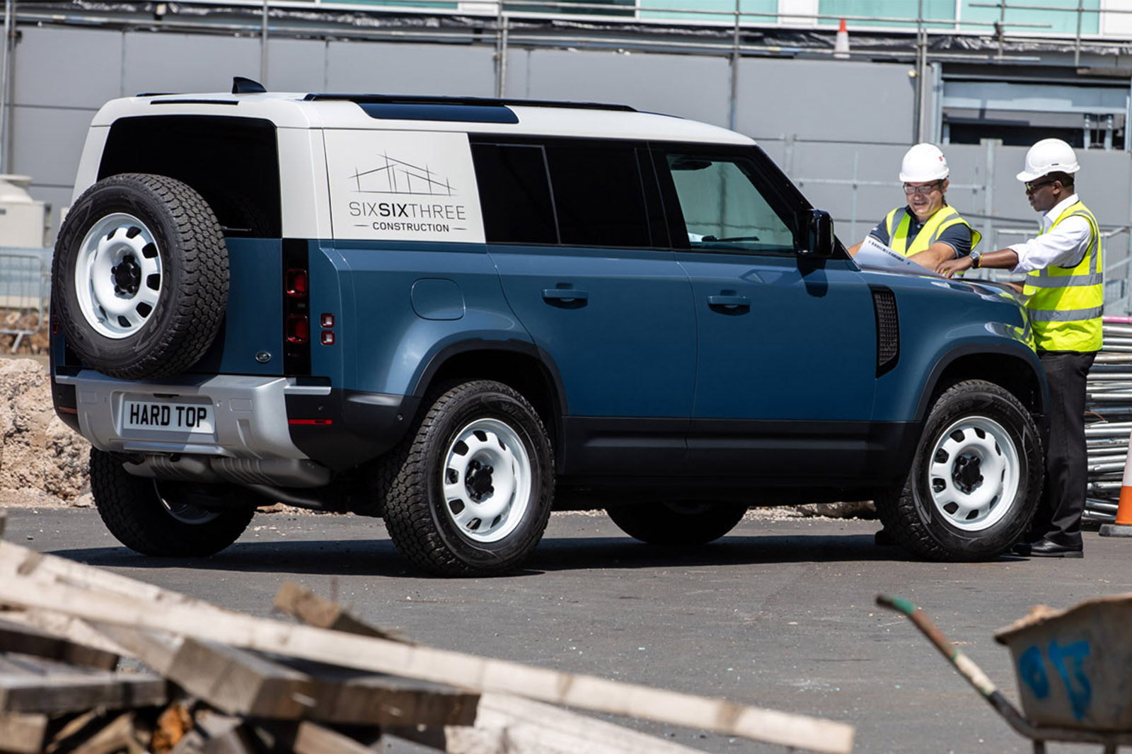

I think they’re just using the name. Honestly a more accurate name would be “utility” like the later last gen 110’s. A pop top is still possible with a fixed roof they did with the LR3/4 and newer unibody vans.
Thanks, that’s what I was thinking too.
I am looking forward to seeing one in person. Hard for me to tell if they really lend themselves to that pop top/conversion arrangement from photos - it looks too small but folks keep saying they are bigger than they seem. Now I’m off to go learn more about the pop tops you’ve mentioned! No shortage of creative designers out there.
My guess is the 110 will be on the small side. Supposedly a longer 130 is coming so that will be better for a pop top.
