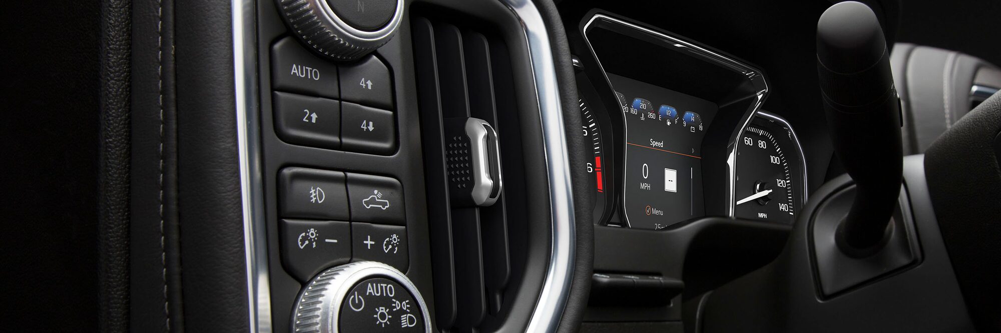

That's odd. All of the 4wd Colorado/Canyons have 4Lo as well as Auto4wd.
The GMC Sierra AT4 has it too along with terrain management. Maybe the 2spd transfer case is only available with a specific package? https://www.gmc.com/gmc-life/trucks/all-new-sierra-traction-select-system

Agreed. Auto4wd is labeled as useful on road when conditions are unpredicable like severe rain or snow but when 4hi is overkill. Because it doesn't fully lock it makes steering easy and doesn't cause bind like 4hi or 4lo do. I find it VERY helpful during winter when roads are slick, especially with an empty bed. But the AutoTrac (GM) system isn't new. My old '01 GMC Sierra Z71 had it. :)
