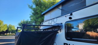

Has anyone posted on attaching the outdoor shower privacy tent? The mounting brackets and bolts were without instructions and I can't wrap by brain around a solution.
The suction cups and rope is something I added because the shower walls sagged so much. Hope this helps
