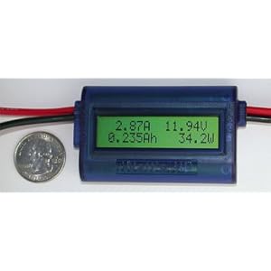

Anyhow, I want to figure out how to quantify what sort of charge and load the Optima is getting in my truck versus what sort of charge the Vector 1089A gives it. That notion is about the only thing that Optima has given me that I can work on but I don't know if the simple instruments that I have can properly capture the data. How much time it is worth to argue with a company that will pay a full-time employee to monitor all the forums and rebut any notion of quality problems?
